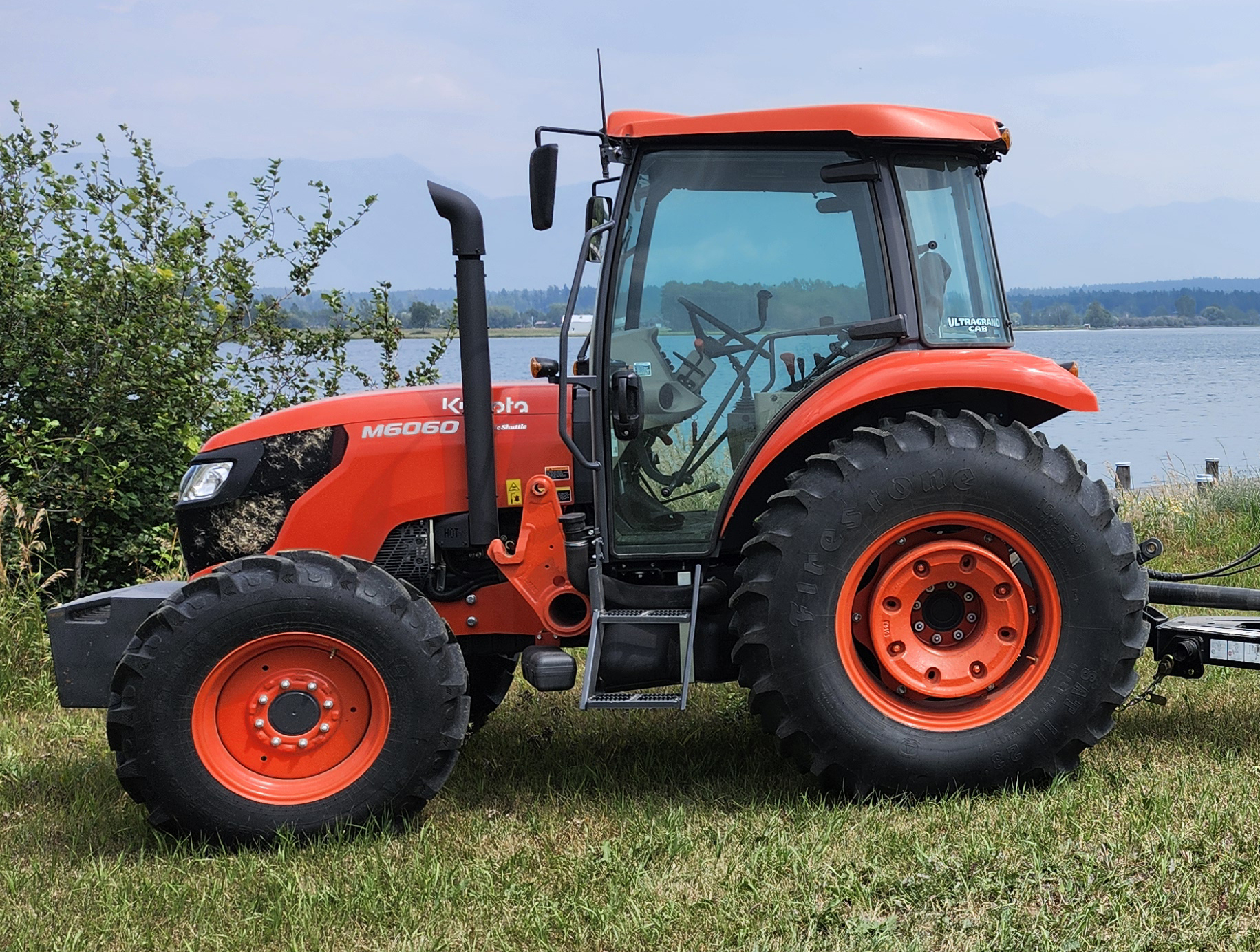

Also if you happen to have a photo of your M6060 with the exhaust I would love to see it.
Not sure that my photos will be of much help since I wanted to solve a different problem but here are the before and after shots. The only parts of the exhaust stack that I repurposed are the tip and a couple of pieces of heat shield. The shield with HOT cut out is unchanged, but I had to cut a piece from the original heat shield for the lower half of the stack. I drilled holes for venturi effects in the base plate below the exhuast tip, and I have an integral muffler in the stack that has a similar O.D. as the the original heat shield.
Reducing the height of the exhaust stack was mainly intended to reduce the loads on the bracket that bolts to the engine block, but an additional benefit is that the stack isn't so obtrusive in terms of the view out the front. Not a big deal but a nice change.
