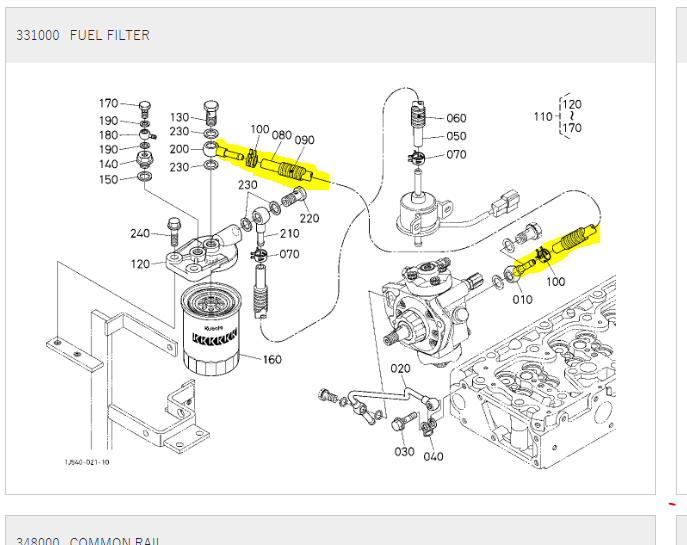

My m110gx is a crank no start. I had the dealership come hook up a laptop and it had low rail pressure 2200 psi. No other codes. They suggested the suction control valve on the side of the high pressure pump was the cause, it wasn’t. They wanted me to bring it to their shop so they could drop the tank and do tests at $150/hr. He said there is no bench test for the pump so I decided to pull the injectors and have my local shop test, they all tested perfect. I’ve pulled the rubber hose off the relief valve it’s dry. I’m guessing my only other option is put on a new pump and hope that’s my problem. I’m wanting to make sure there is nothing else to test before I buy a new pump. Any suggestions?

Do you know the gpm or psi that the transfer pump should produce. I have made sure it is supplying fuel but I have not tested gpm or psi. It seems to have good flow.

There will be little pressure involved and flow should be moderate.
Do you get good flow to the high pressure pump?

Yes sir I’ve checked flow there and the dealer mechanic did as well I believe.
