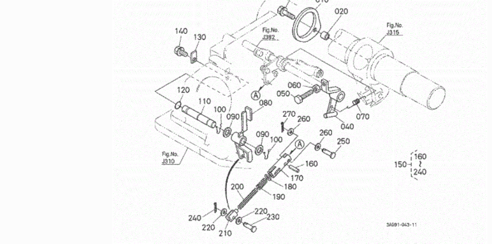

Purchased a new to me kubota m108s with the swing shift transmission also has a side arm mower . Used it today for about 2.5 hrs an noticed the cab floor getting hot, the rear end housing was hot enough to boil my spit. Hyd oil looks good, a little over full. Brakes not dragging, rolls good to a stop. Radiator and coolers are good an clean. The boom mower is not tied into the tractor it is a self contained unit. Tractor seems to run good, shift good etc. Anyone had trouble in the area before. Thanks
Unhooked the draft control linkage thinking it might be holding the lift arms up, lift arms are stuck up. Ran for a hr after an started getting hot again.
