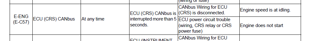

I have a 2014 M100GX. I was brushhogging and the tractor shut down. The warning is E-ENG. I have checked the fuses and none blown. I checked wiring harnesses and didn't see any problems. I have just ordered a work shop manual. The tractor will not crank over and the warning is still displayed.. 1- Does anyone have any experience with this issue? 2- Is there a way to get more detail about the warning as I am guessing E-ENG is very broad and general 3- How do I reset the warning? I have never had an issue with this tractor at all and bought it new 11 years ago. The tractor has 2300 hours. Thanks.

Thank you. I found the 5 amp fuse blown for the PTO circuitry. Replaced fuse and the error cleared and the tractor started. I drove it home but haven't engaged the PTO yet. Looking at the schematic it could be PTO valve solenoid, PTO relay, switch, or wiring. I suspect the valve solenoid. I will troubleshoot as time permits. Not sure if the valve solenoid replacement is in my skill set but I can handle the rest of the possibilities.
