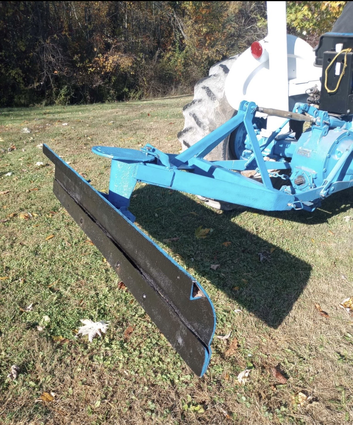

Looking at these. Blue one is 7’, old, only angles.

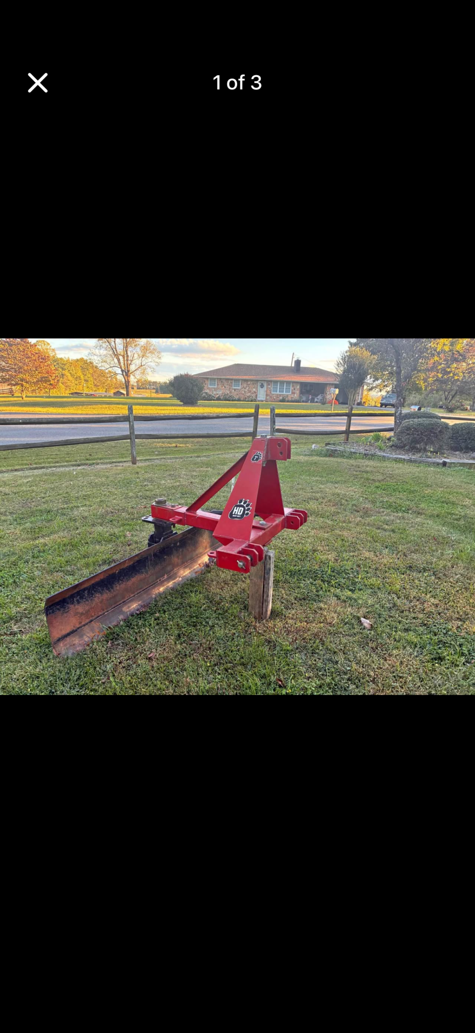

Red one offsets and angles. 7’

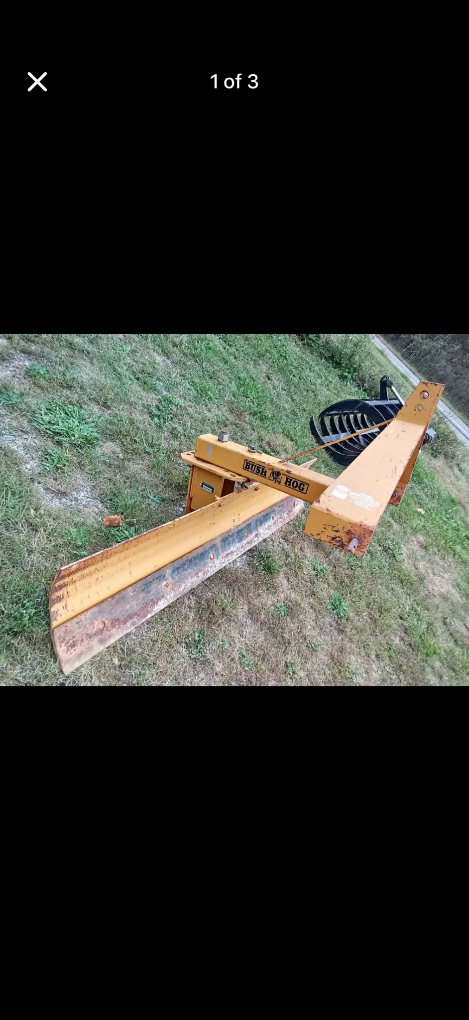

Yellow is 6’ and I think moves in all ways
