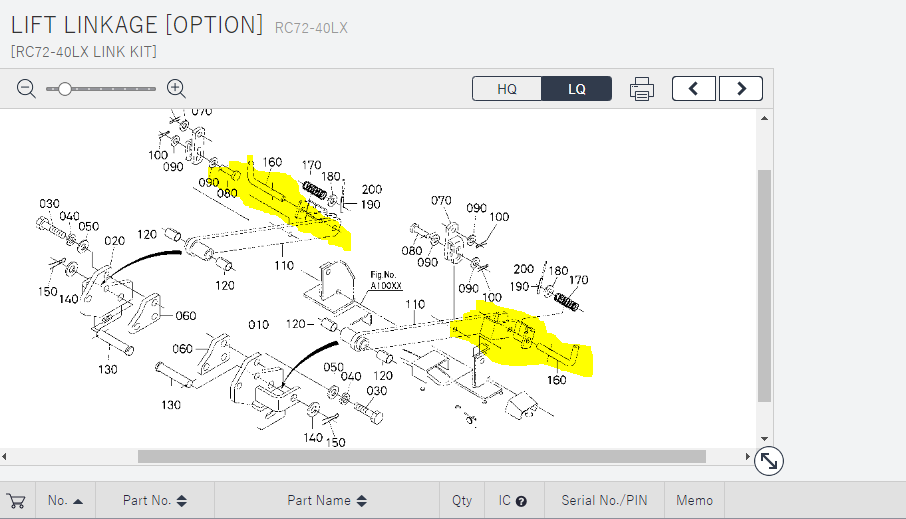

Look on the rear of the deck for these latches:
Looks like it might be an optional kit?
30,125
6,296
Thanks for the info and I'll give it a close look today. I'll go by the farm supply store and get some pin this morning.
You don't add the pins, the pins are already there or they are not.
If they are not there you need to have the dealer order the brackets and pins as a kit, and either you or them needs to install that kit.
Like I said I do believe this is an optional kit, and that kit may or may not be available yet.
Added Note: This is not necessary the solution to your issue, I'm just going off of what I can see on a set of blueprints, I don't have one in front of me to make an exact determination as to what is needed.
