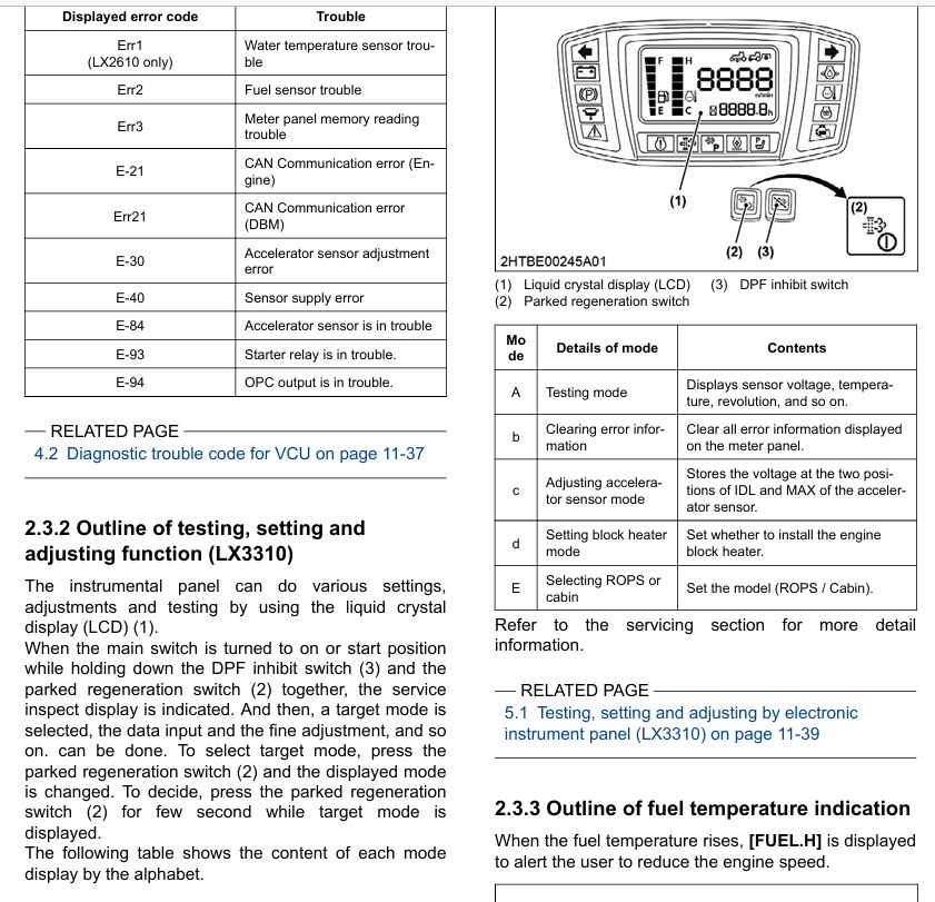

I found a reference saying that is a communication error to the engine. Is it still starting and running okay? It might clear itself but if it doesn't I would look for any loose or dirty connections. Might try unplugging and plugging the ECU back in? I think it's under the seat but I haven't verified that. The manual I have doesn't tell you where it's at or how to begin troubleshooting that error. AI wasn't much help either. It says under the dash or near the seat.

Edit 2: THE ECU for an ROPS model is under the dash. For a cab model it is under the seat. Hope that helps.

Shouldn't be a hard code if the machine still functions okay. The image I shared in post #2 gives instructions on reading and clearing codes. You might just try to clear it.
I got the code cleared by doing as you said, Delete it through the dash programing. Hopefully it doesn't come back. Thanks to all for the suggestions and especially Old Machinist. 👨‍🌾
