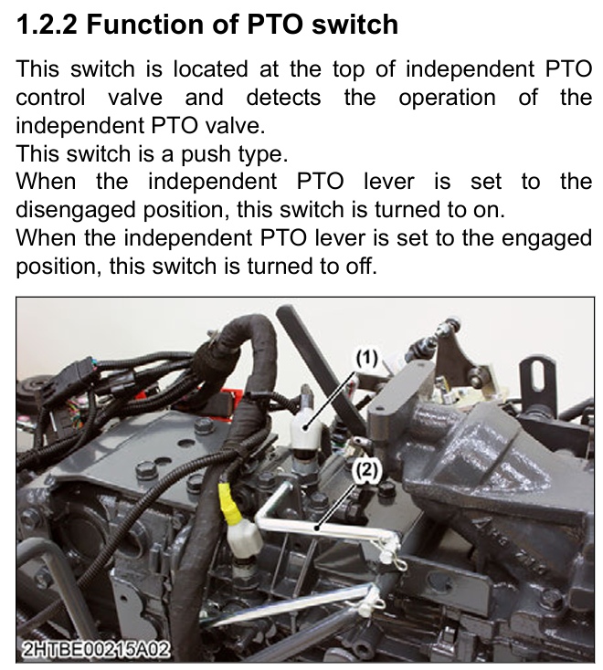

The last couple of times I have mowed when I disengage the PTO and get out the engine shuts off as if the PTO is still engaged. It won't restart until I let it cool and operate the PTO lever on and off then restart.
Switch looks like it might be impossible to access with the cab on but I haven't gotten under it to verify. The WSM shows the switch right on top of the transmission.
Anybody run into this an have any tips to access the switch?
