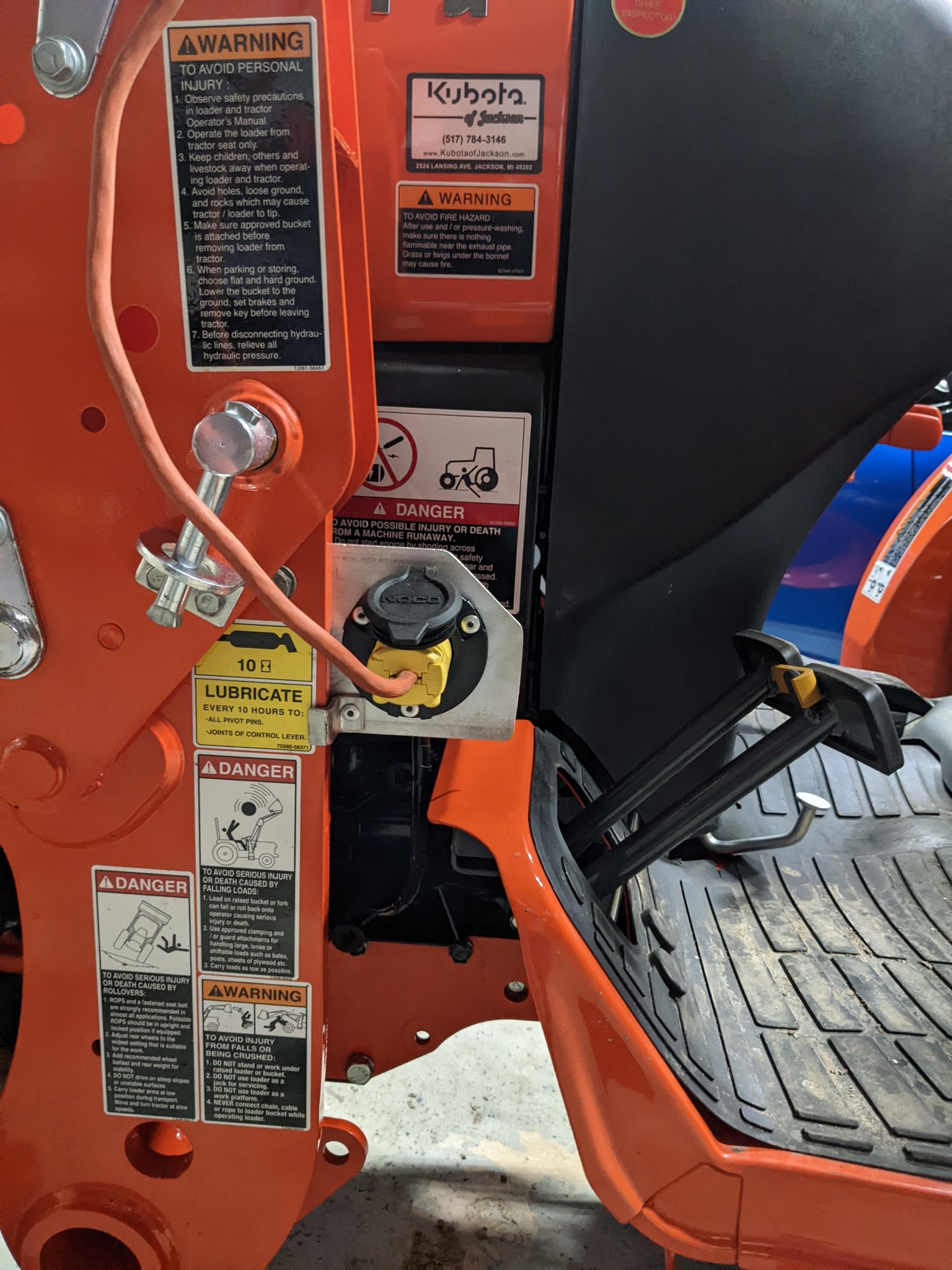

As I recall the threaded plug in the block takes a 17mm hex bit. The block heater is a 1-3/8 socket.
I have Wi-Fi in my barn so I have a Wi-Fi controlled outlet that I turn on about 1 hour before I go out to start the tractor. I use mine mostly because I want to limit the really cold starts as that causes extra wear & tear on the motor. Just a FYI the factory tightens plug in the block to 100+ FtLbs. Yes use pipe dope or Teflon tape on the heater or in really cold weather it can and will seep a little.
On mine I have an outlet for the extension cord to plug into so it's more convenient to plug in.
