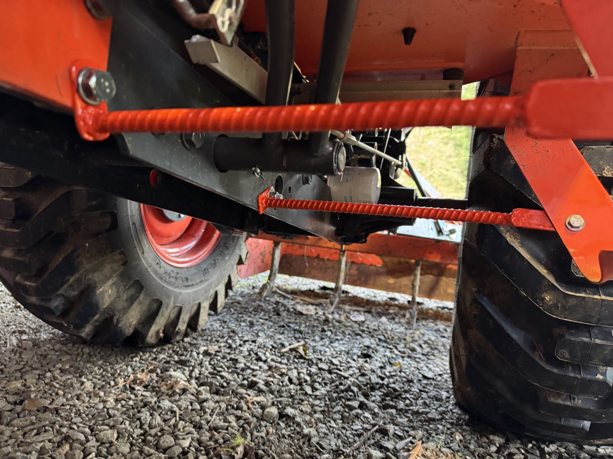

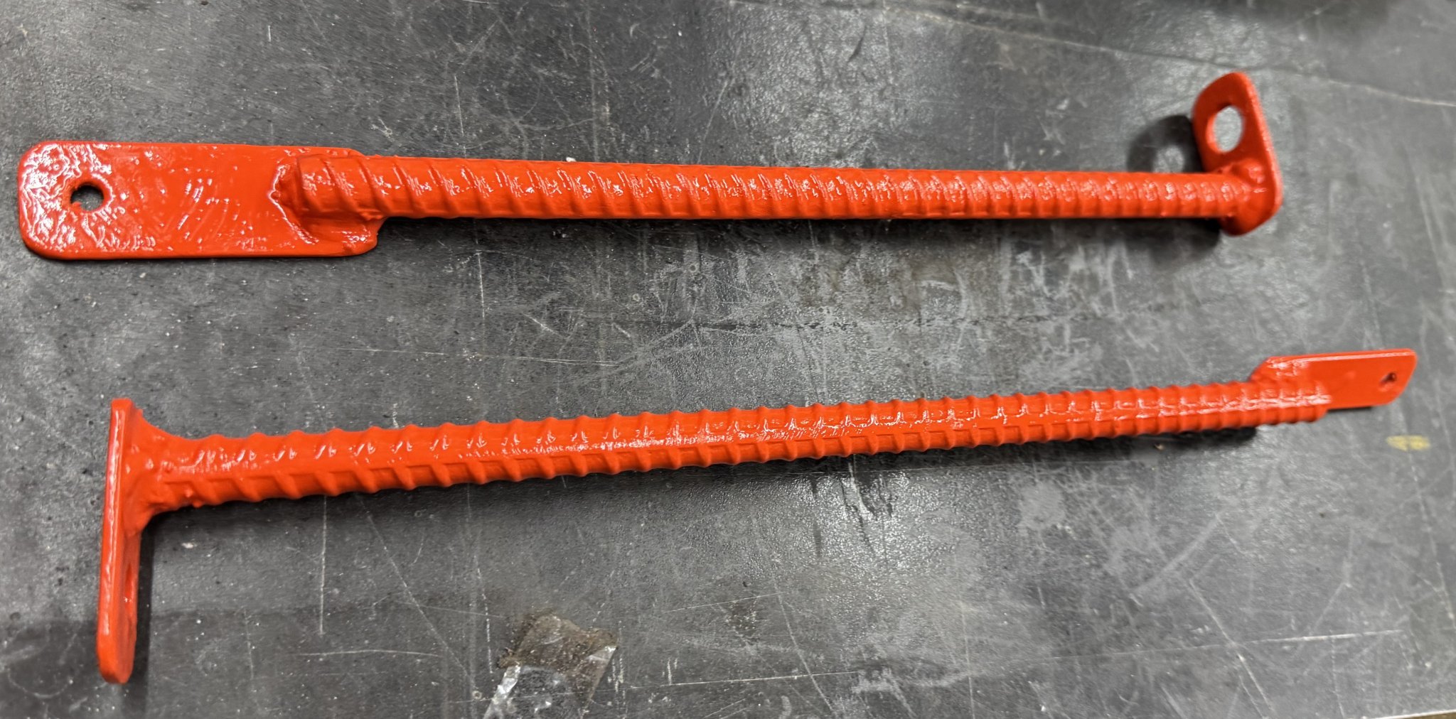

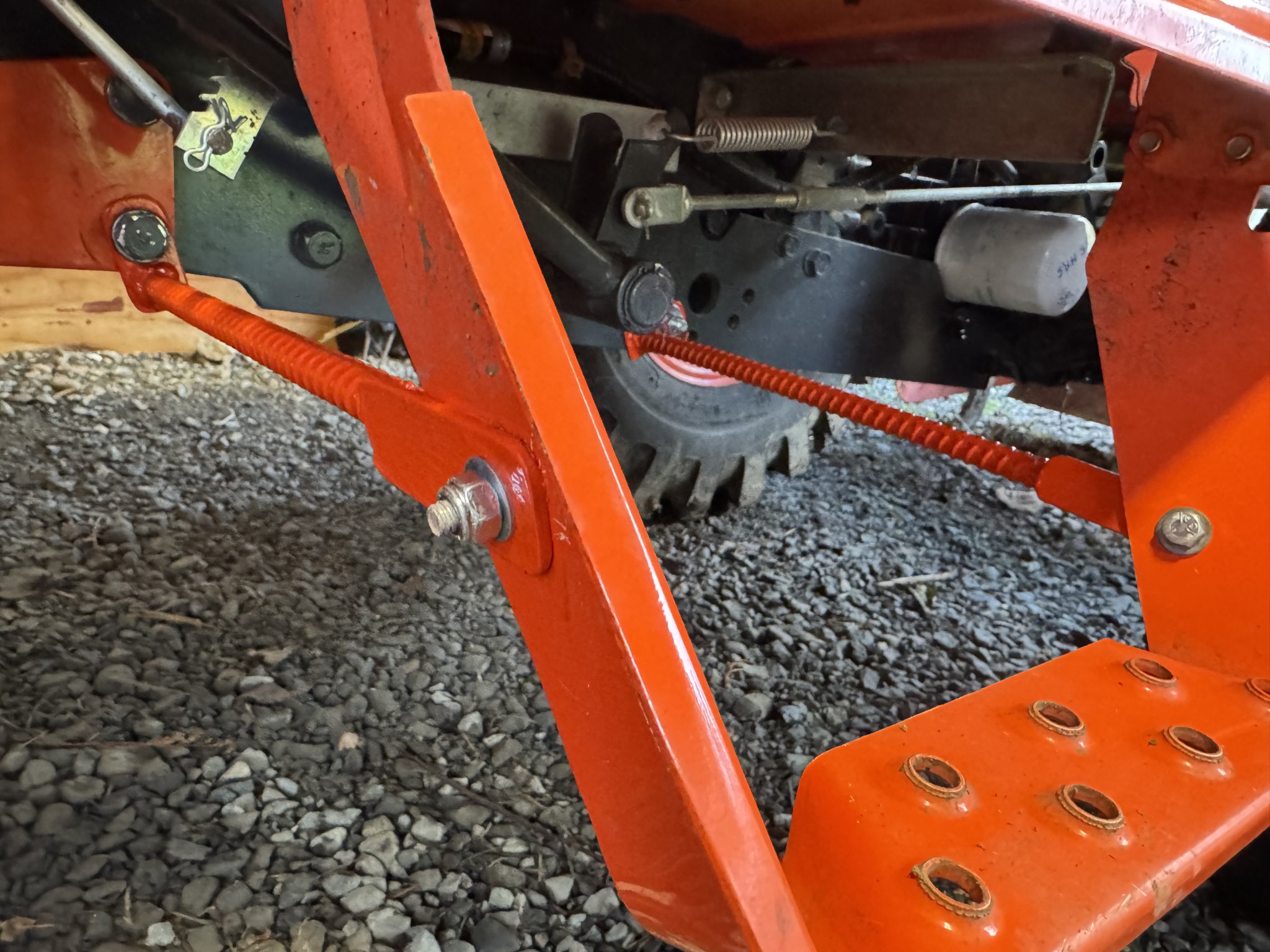

Saw a really old thread on making step a little stiffer and decided to do myself. Couldnt stand how when my 230lbs stepped on it the whole floor and fender moved a half inch. Prob not an issue but why not.
5/8" rebar and some 1/8" x 1" plate. Super simple and effective. Super solid now.

Nice Job!
Simple yet effective (y)
It’s on my ”list” ………It’s one of those things that I keep meaning to do, but never get to it.

I've been meaning to do something very similar on my LX2620. Thank you for the inspiration.
