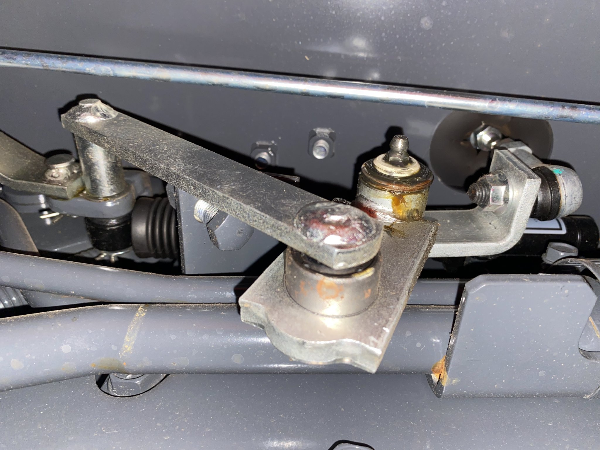

I have an LX2610 with a cab and there is a zerk on the hst pedal. I won’t be able to get a pic until the ground starts to dry. However, it’s at the pivot point of the treadle under the floor.
Maybe the ROPS is different. But mine definitely has a zerk

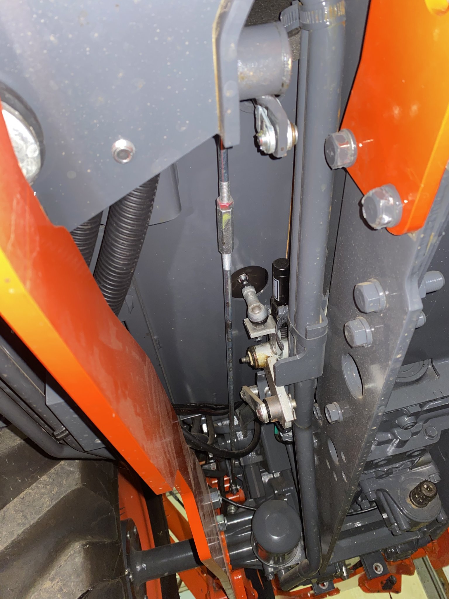

I’ll try to snap a pic today. It’s underneath. Not sure if the non cabbed model is different

Mine definitely doesn't have that zerk.
Anyone with a ropps able to provide some pictures? I can't think of why cab vs ropps would matter for that, but everyone I've seen say they have an hst zerk has had a cab.
yeah that’s definitely odd. I’d love to see pics of a rops model

The cabin models have an extra mount for the pedal to the cabin floor, then a linkage to the holder. On the ROPS model, the pedal is mounted to the holder.
The zerk on a cabin model is in the mount which a ROPS model does not have.

Based on what I read in the owner's manual, the ROPS do not have a grease fitting on the HST while the factory cab units do have a grease fitting.
