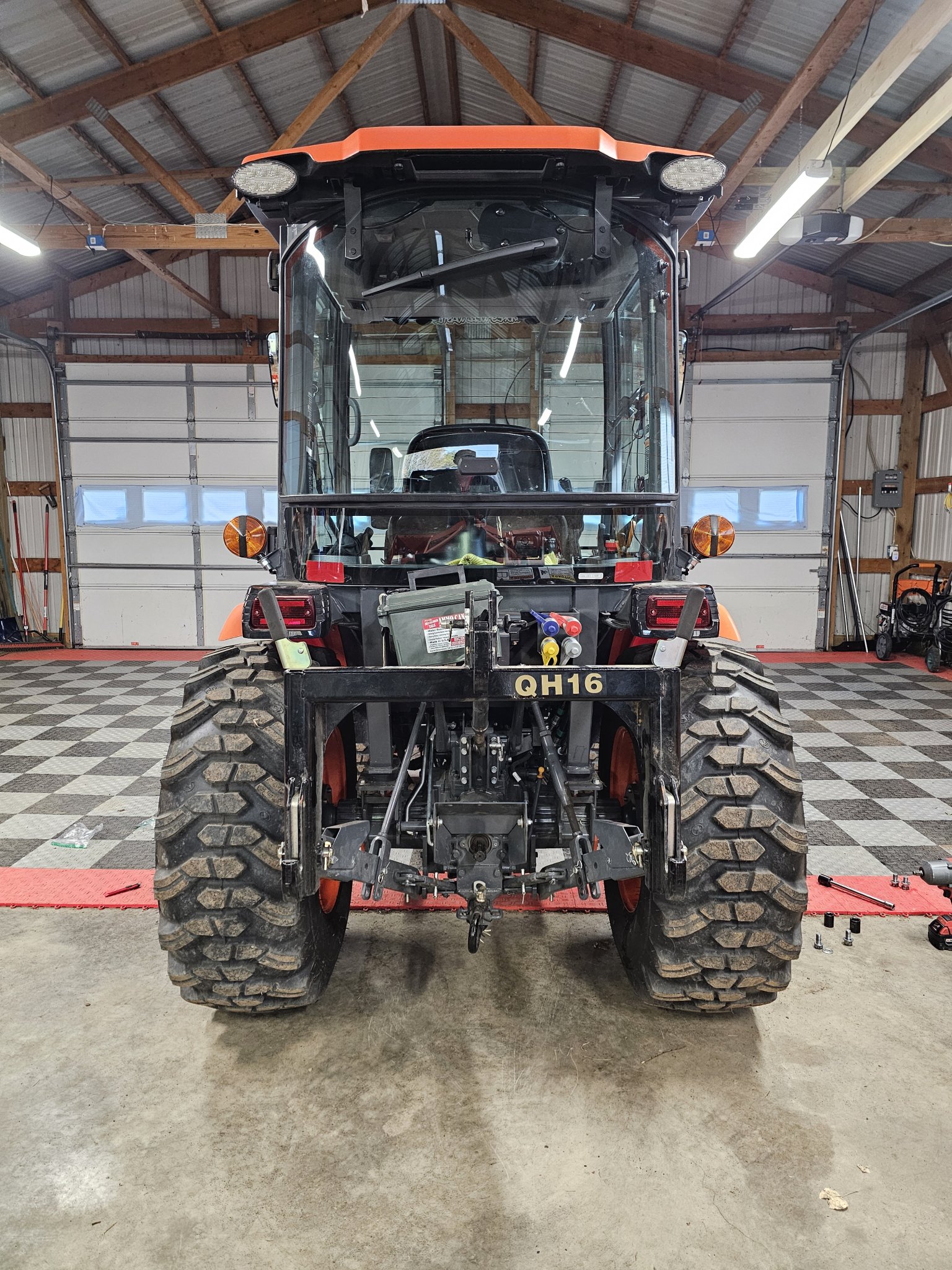

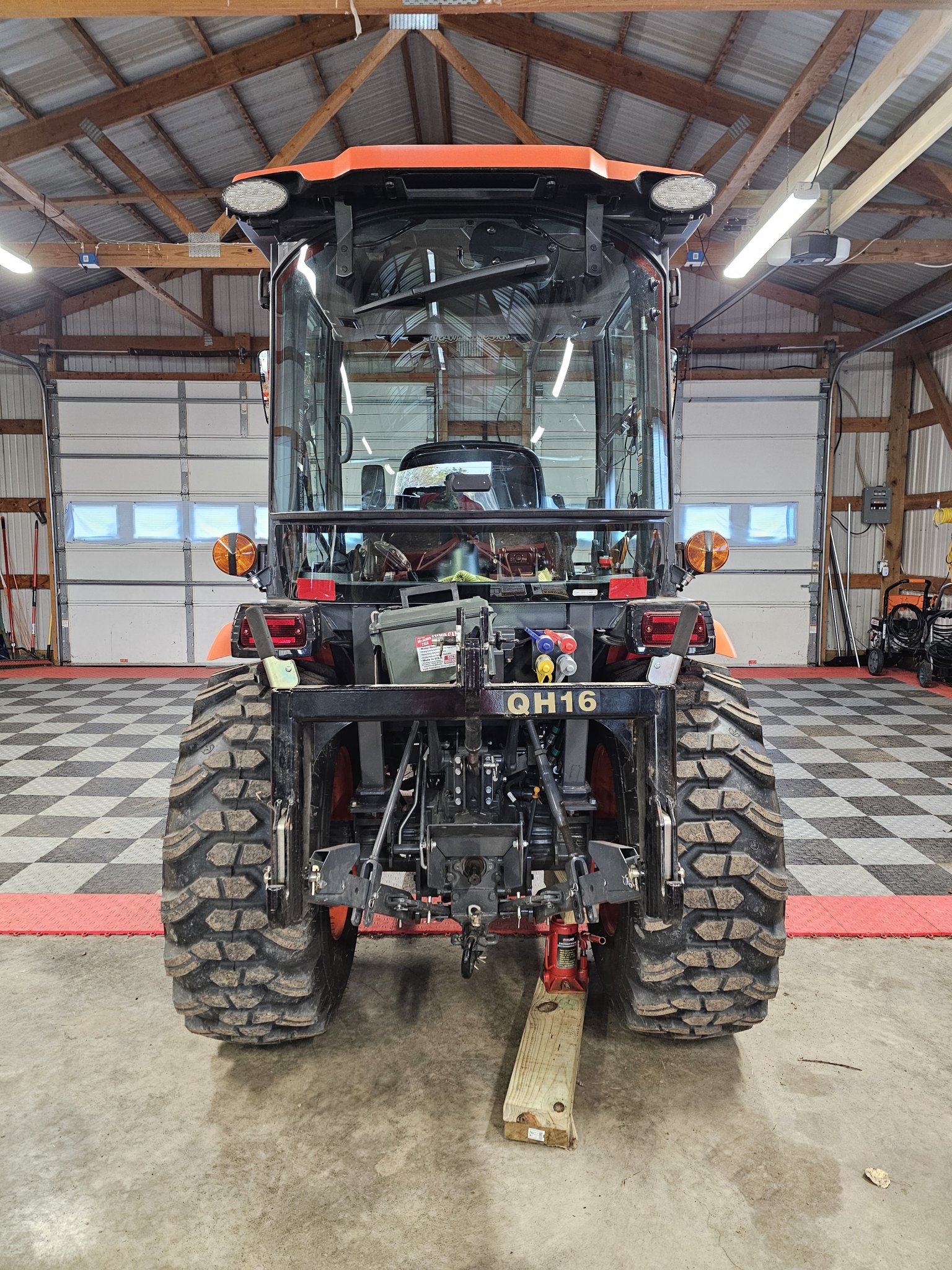

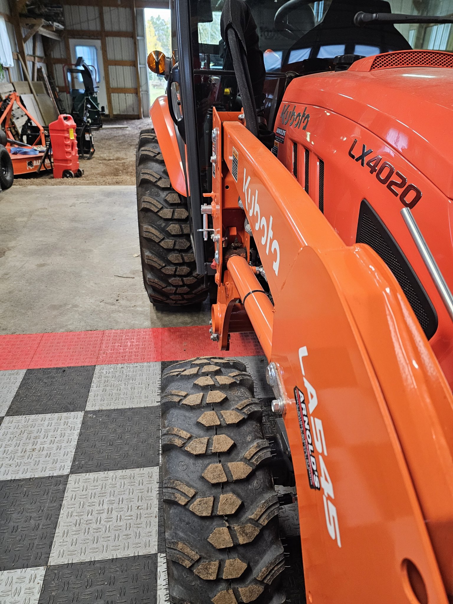

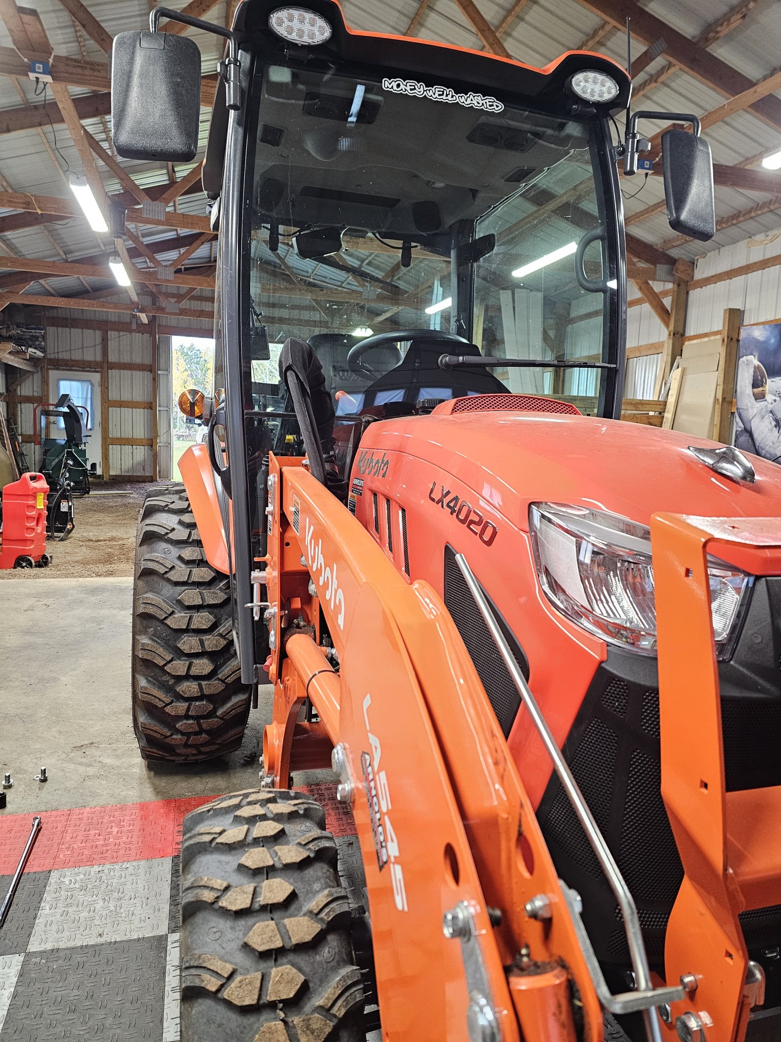

I bought an LX4020 cab last year and kept my BX2370 mainly for mowing and working in tight spaces. I love having the cab on the LX4020, bug free and cool in the summer and warm and dry when snow blowing in the winter. I also have the oversize R14 tires and they are filled. All that said, I would rate the "tippyness" of both tractors to be about the same. An LX4020 ROPS with the same filled tires would obviously be less tippy, but also less comfortable in the heat of summer and the cold of winter.

I thought the larger tires weren't compatible with the mower - one or the other. They interfere when you turn sharply I believe. So if the reason for the LX is the MMM, then the larger tires may be a no go.
Spacers are important if you care about stability. I don't believe an LX (or an L) to be any more stable than a BX, other than (as you say) with a loader. The BX loader shifts the centre of gravity a lot. I'd recommend mowing without a loader though.
