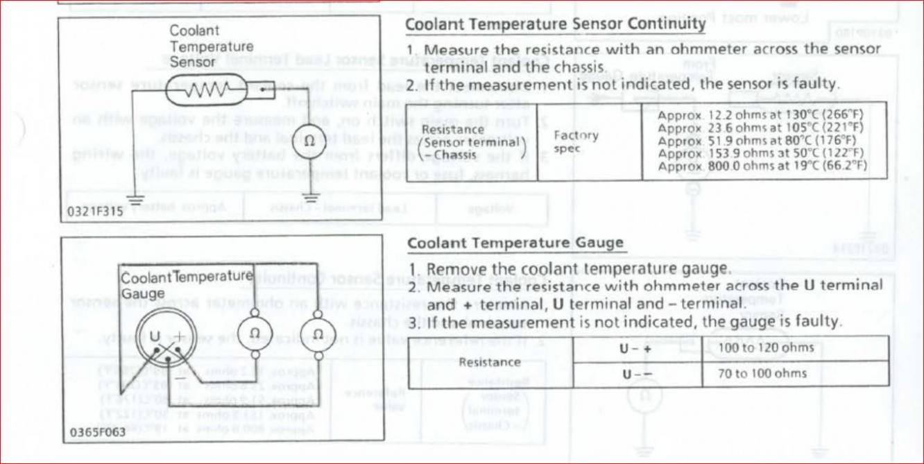

First do these checks and make sure all the supporting parts are doing there job.
31,421
7,244
To get to the temp gauge, remove the 4 bolts on the plate behind the dash, remove plate unscrew tachometer cable. Remove 4 bolts that hold the cluster in place, gently pull cluster out remove 2 electrical plugs do tests. Remove the wire off of the temp sensor and make sure it does not touch ground. If both Ohm tests pass then remove the screws to get the frame and clear cover off. On the temp gauge, gently pull up on the needle and pull it off the shaft, replace the needle back onto the shaft only partially at about the 10 O'clock position. Connect the 2 plugs onto the cluster and turn the key to on, the gauge should move down towards the stop and it should stop before the needle touches the stop. Once the needle stops moving, shut off key, gently without rotating the shaft remove the needle, (optional) put a very tiny drop of lock tite in the hole for the shaft to lock it, reinstall the needle where it now contacts the stop. Reassemble and reconnect everything and you should be set.

Sweeeeeeet...............done, done and done.
Mine turns out to be a little different to yours but near enough.
Readings were a little high on the ohm's (for the meter, sender seems fine) but acceptable, so the reset is a bit of a compromise because it goes a little too low and a little too high when grounded so I essentially split the difference.
Brilliant, thanks for going to the trouble to explain :).
