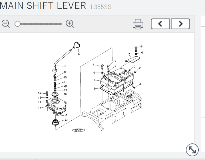

Big Tony 47 New member Equipment L355SS Sep 29, 2025 1 0 1 47 Williamsport,In Oct 3, 2025 #1 goes in low but as soon as it gets a little strain on it starts grinding and wont pull itself
North Idaho Wolfman Moderator Staff member Lifetime Member Equipment L3450DT-GST, Woods FEL, B7100 HSD, FEL, 60" SB, 743 Bobcat with V2203, and more Jun 9, 2013 34,077 9,277 113 Sandpoint, ID Oct 3, 2025 #2 Have you looked at the WSM for possible causes? Do you feel the detent engage? Could be the lever has gotten bent and won't let it fully engage? On this model it's fairly easy to pop off the main shifter and have a look at all the gears and such.
