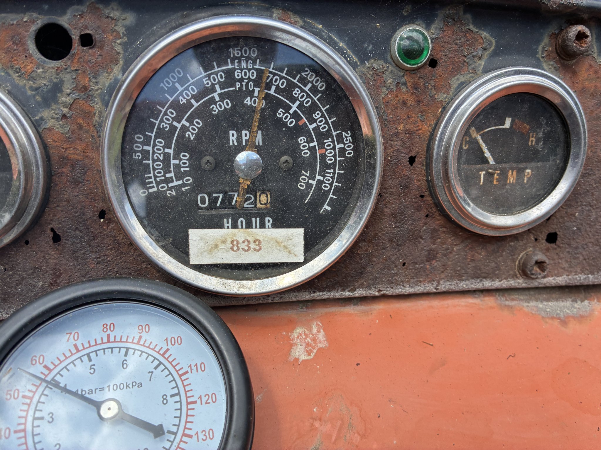

Not original owner, I don’t know how many people owned the tractor before me, but I think only one. 750 hrs if gauge is original, I think it is because the tractor is tight.
all fluids and filter changed on coming back to my farm (Kubota filters)
Oil light would come on after the engine oil was warm/hot and engine brought down idle. I know in the book it says this is OK but it still seemed strange so I put a gauge on it. Gauge was reading between 7 and 10 psi at idle and 25 at warm/hot oil - pto rpm. Cool/cold oil 56 psi. Parked it.
checked oil relief valve on filter housing- seems OK
Change the oil filter again - no change
Dropped oil pan cleaned the strainer and change the O-ring gained 8 to 10 psi
Changed oil pump and orings in gear case/ front cover - no change.
I know I have more troubleshooting to do. Enjoy the videos below.
