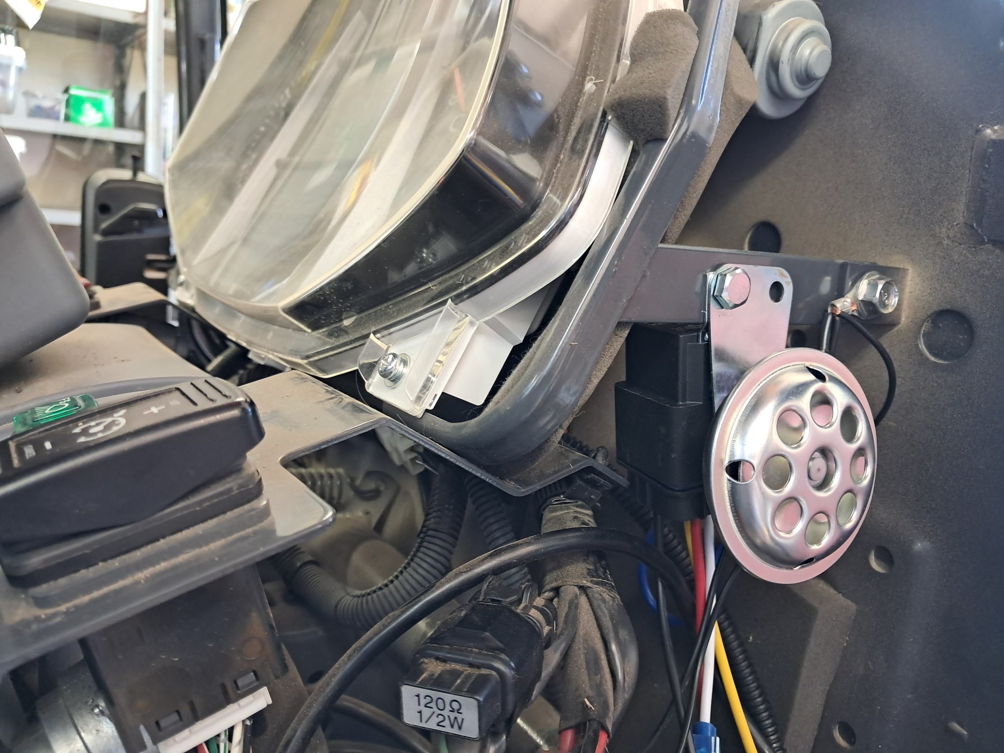

Both of them I installed a relay that runs the horn. I ran a wire to the oil pressure switch. I disconnected the wire from the switch that went to the light.
When you don't have oil pressure the switch goes to ground.
I used the same horn that ZD1211 uses if it gets to hot.
On the tractor I added switch so I can shut it off if I want the key on with the engine off.
K7501-61550-620 Horn
This is the relay I used. It is way bigger than I need.

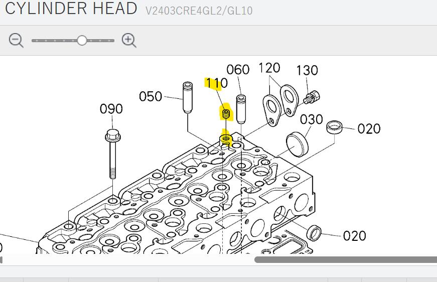

DO NOT tie into the factory temp sending unit because the computer uses it to tell the glow plugs when to operate.
If you want to add a temp switch add one to this port.
