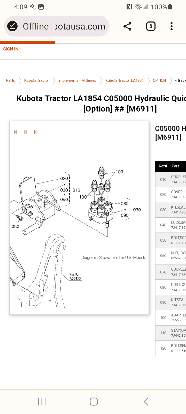

We talking about the rear remotes that are mounted directly on the valves? If so I think they are a high dollar Faster push-pull agricultural coupler (3CFPV). Do they look like this? The specific part number should be etched on the body of the coupler. And yes, there are hose ends that match the port threads in the valve but you will lose the convenience of the push/pull connectivity.
EDIT - I see you are apparently talking about the couplers on the LA1854 loader. So now I am confused. Those look like normal AG couplers.
EDIT2 - I see there is a Multifaster quick coupler option for the loader. Is this what you are talking about?

As mentioned above I guess they are called flat face couplers, they use them on this as there is no room for pioneer style unless you add short hose pieces that are the weird thread style. Also this loader is an M16 not a LA1854
Something about my environment is making them terrible, pioneer style never have issues but it would be difficult to swap them in here
