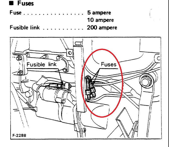

Do you have an operators' manual?
If you do not, start a Conversation with me by clicking on my name on the left of this post and send me your email address.
There are two fuses in individual in line fuse holders as shown in the following:
With issues as you describe them, I would be looking for wires damaged by rodents.

Loose terminal… either at the panel-ground or the power-lead.
Dave
RODENTS! Those little buggers carry trash in from long distances to nest in my mower engines. I stored insulation in the barn, come spring I start the tractor and pink snow is everywhere.
