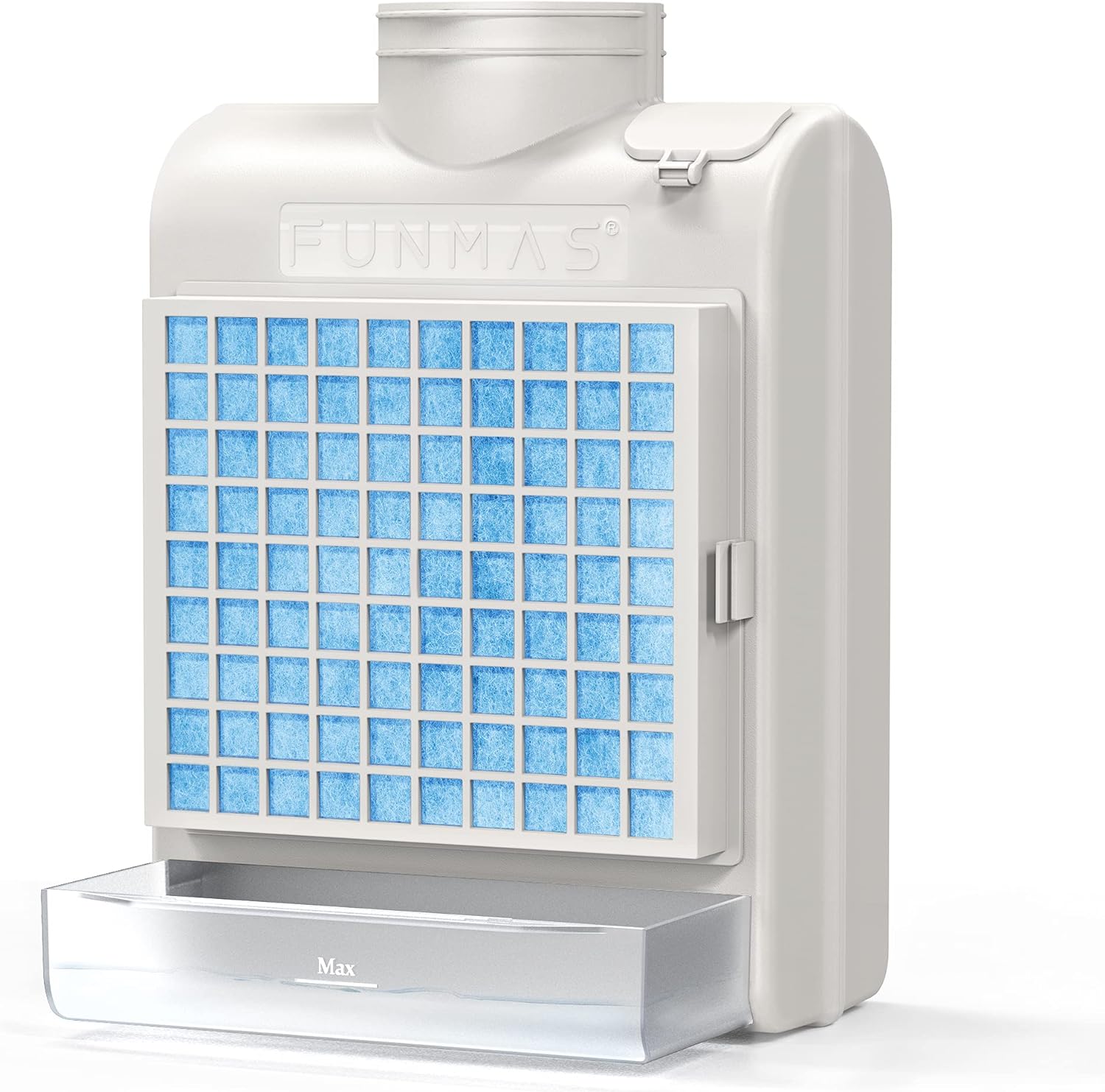

I presume it is electric because venting a gas dryer into a garage would not be ideal. I would suggest looking at an indoor dryer vent. Many different ones available at most hardware stores and online like amazon.

I presume it is electric because venting a gas dryer into a garage would not be ideal. I would suggest looking at an indoor dryer vent. Many different ones available at most hardware stores and online like amazon. View attachment 144912
Yes, it's electric, I think this would would perfectly, wasn't aware that they made these, thanks.

People are inclined to forget to clean the filter in that plastic crap Amazon doo-dad shown above.
