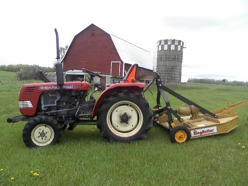

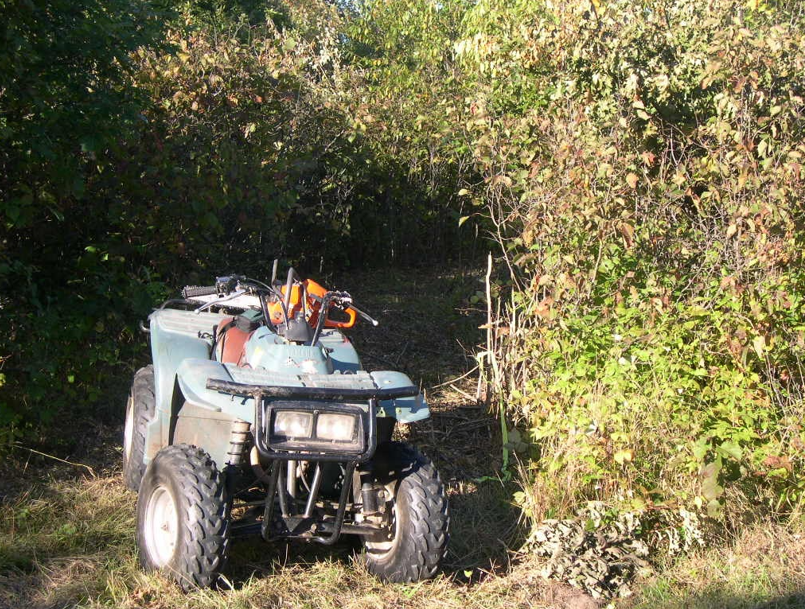

I've owned 3 different Kingkutters (all different sizes) I have worked the snot out of them, and they have been bullet proof. I've cut 8' tall brush with a 15hp Shibaura and a 4' Kingkutter rough cut mower.

I added those. I set the tail end of the cutter a bit high to expedite discharge (and use less power). The Shiibaura had a short wheelbase, and when I was cutting through tall brush, the front skids would dig into the dirt on the uneven ground. (I cut pretty short, so I didn't leave tall stems), The wheels/mounts came off a baler pickup, That setup worked great - no more gouging.
I wish Kingkutter had a more shallow approach angle on the front skid, and a bit wider.

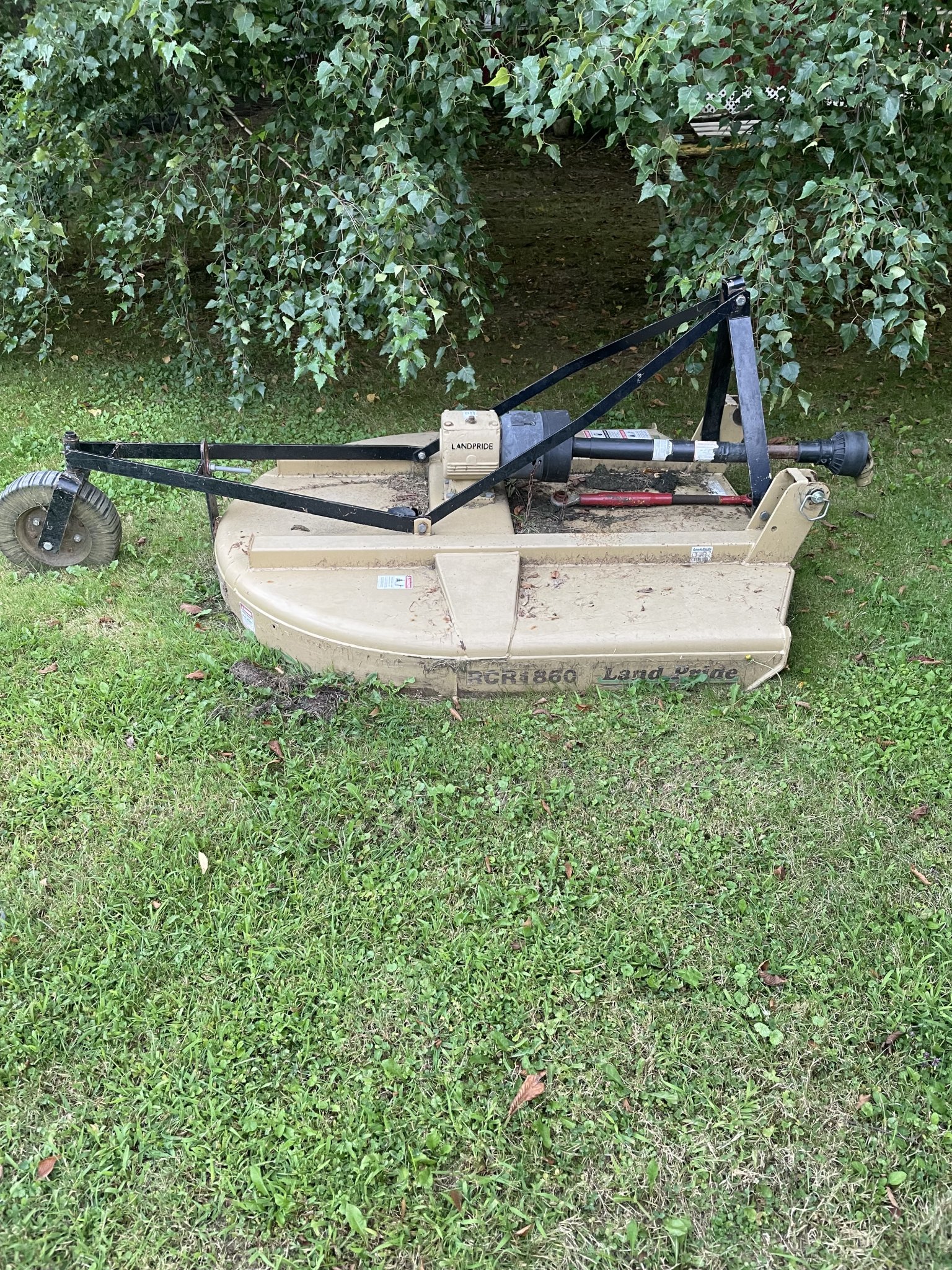

I have a 5’ in pretty good shape and not currently in use. If you are interested to travel to NE Ohio, send me a PM. (It’s probably under snow at the moment)

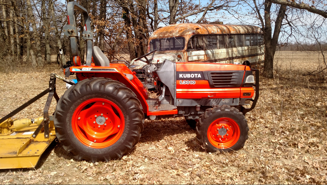

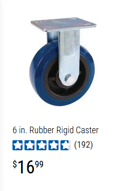

I currently have 5' rough cut mower that I use with my 32 hp Kubota. I've bolted rigid 6" castor wheels at the front corners of my mower to prevent gouging. They work great, and I might have to replace one every 2 or 3 years.
