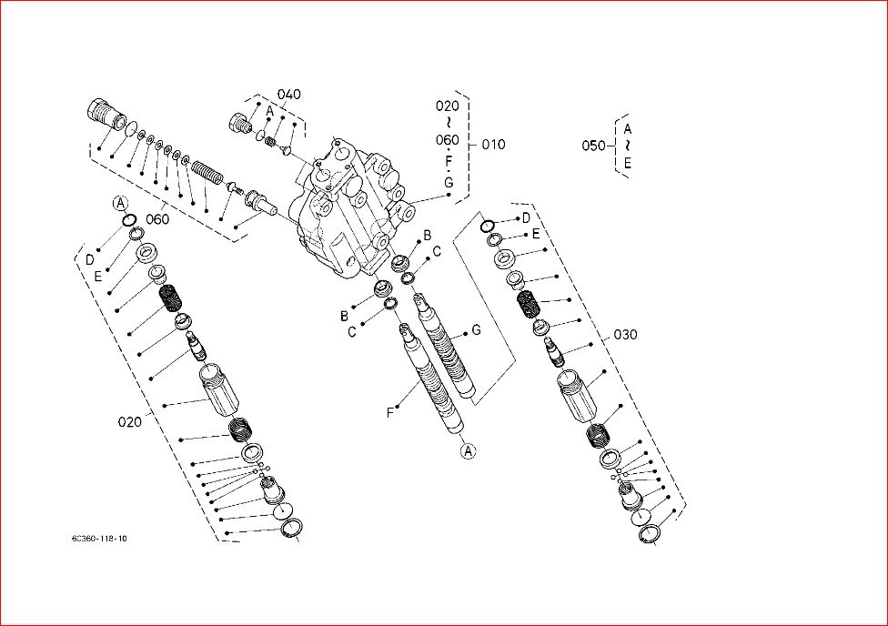

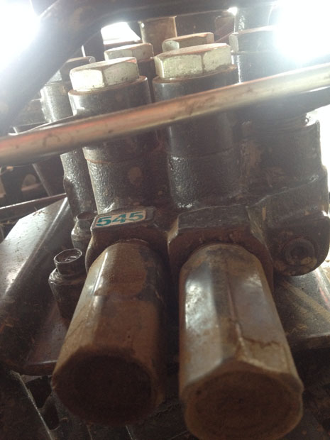

1) I can't ID the mfg. of the valve (no tag on it to identify). Part #, based on parts diagram, is YW545-00100 or -00102 (depending on serial #). Pictures are attached. There is a sticker with "545" on it.
Does this look like one of the infamous Husco valves (that Butch is an expert on)?
2) Does this problem sound like something I could perhaps fix by disassembling the valve? There are some replacement parts for this valve on the parts diagram (each spool has about 20 small pieces to it, and they all come as part of a kit).
