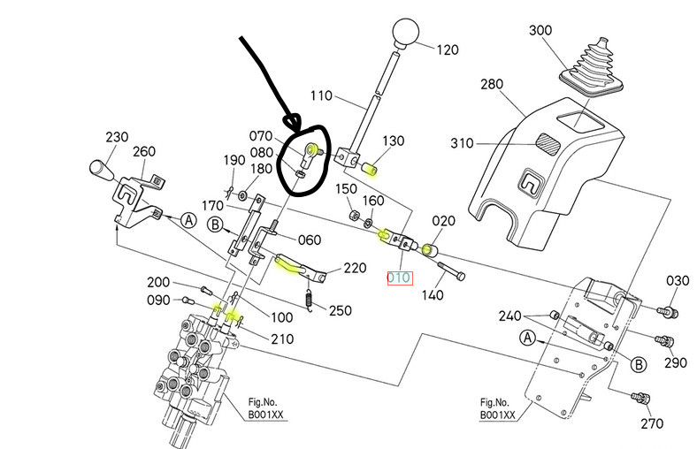

I was operating my L2501 with LA525 when the joystick started feeling not normal. As it happened it then became non-responsive up and down, and was stuck in float. Turned out the heim joint number 070 unscrewed itself from the joystick, part 110. Not sure if this relates to your problem but might be a good place to start.
I was able to diagnose by pulling the rubber dust boot up, part 300, but did have to remove the plastic cover, part 280, to re thread and tighten.
