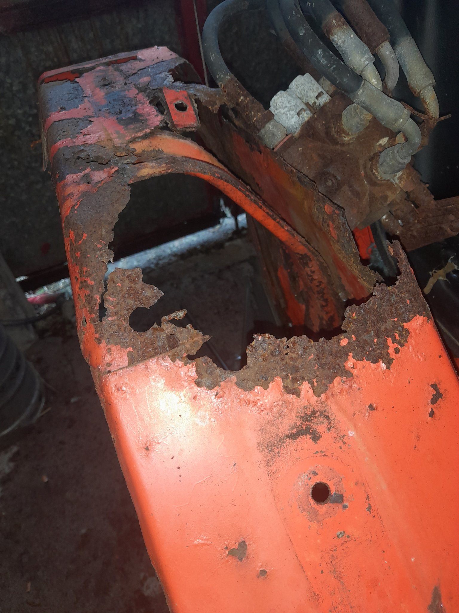

How do I get the cables and housing off the mudguard?
I have removed as many nuts and bolts as I can see.
Trying to get the mudguards off for fiberglass, because they're a little bit rusty.

man that is a LOT of RUST !
ok, I'd think 2 bolts from inside the fender into the 'valve block' ?

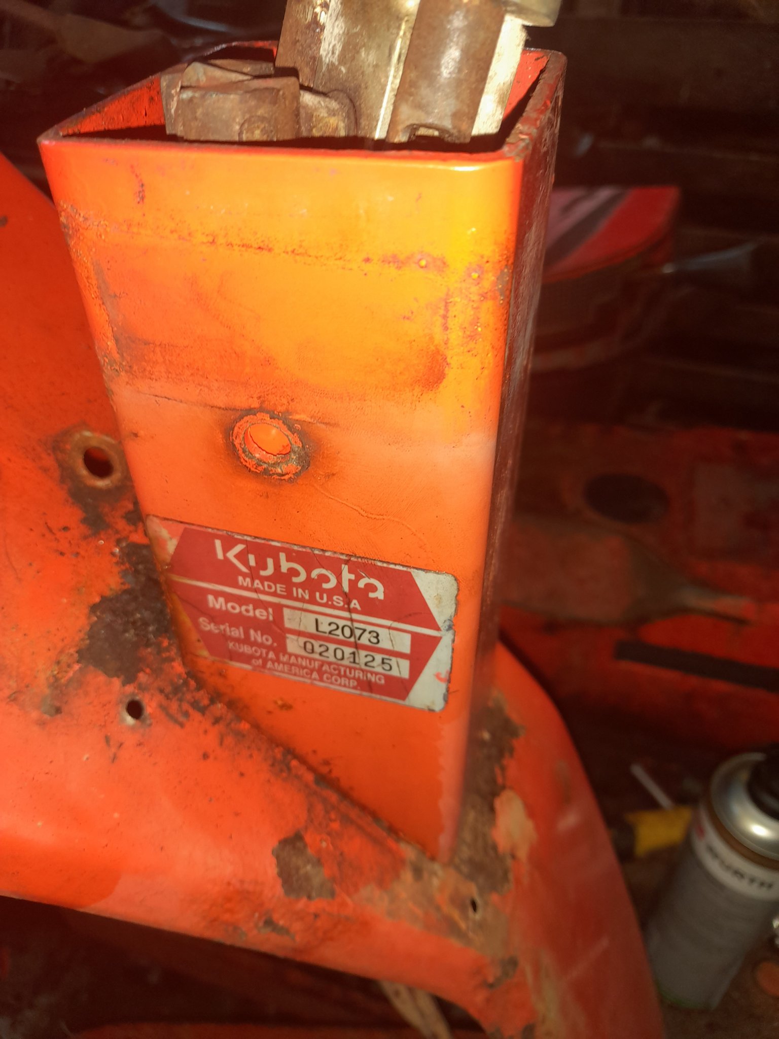

Thanks, Got them. The cables are attached to a plate down inside the square upright thing. The holes in the mudguard are the size of the cables

Is anything going to go flying if I open these covers?
I figure if I open these I will get enough slack to get to the nuts at the bottom of the square upright

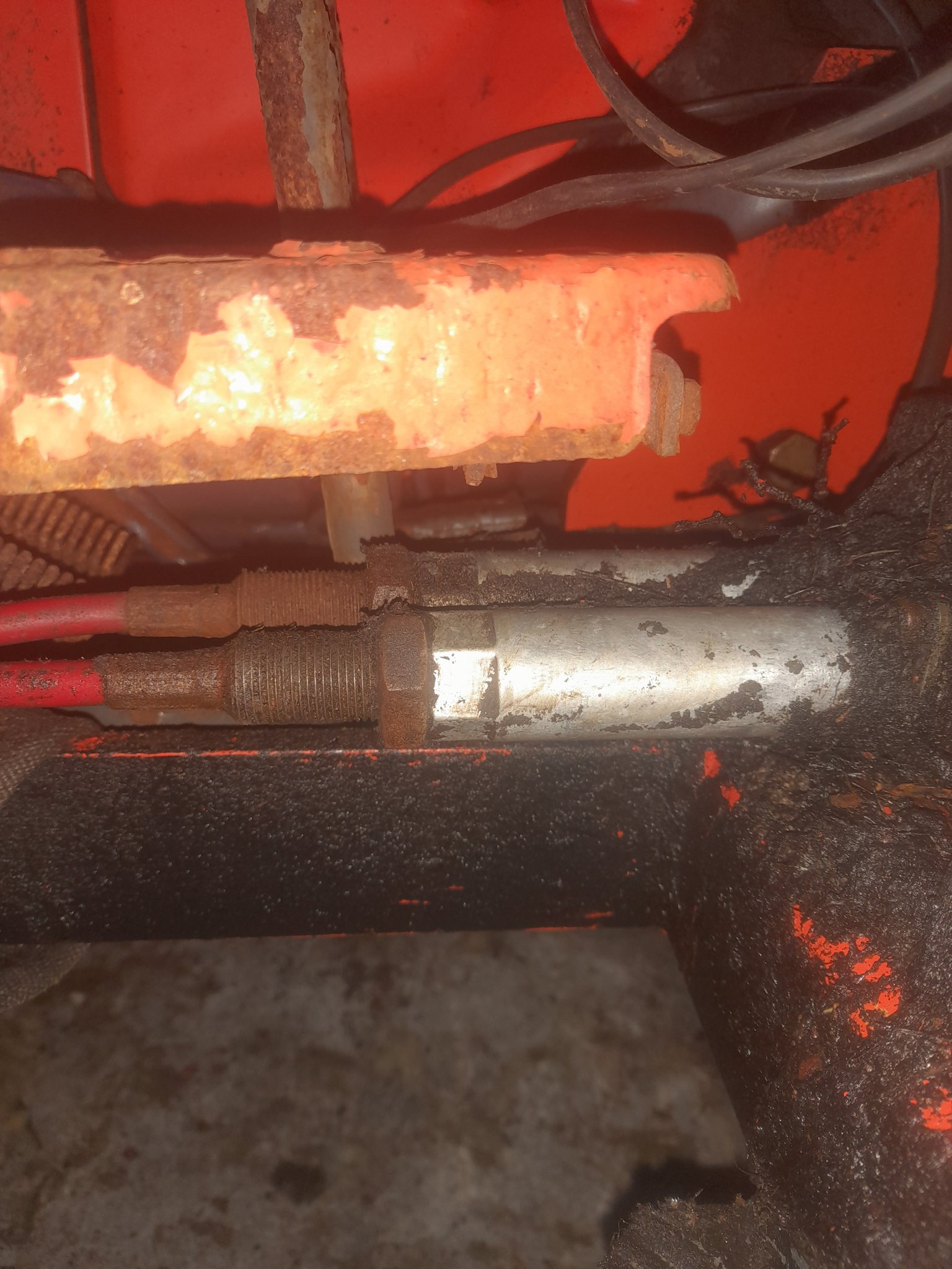

in the top picture of post #3, you can see the cable is threaded into the 'silver' section.
you use proper wrenches to loosen the 'jam nut', then turn cable or end fitting to shorten or lengthen the cable. probably shorten, as cables stretch. Similar to bicycles hand brakes.
Best to 'derust' and clean the threaded sections, light oil, clean them again. Being fine threads, ANY 'gunk' in the threaded will 'bind up'. They should be free to turn.

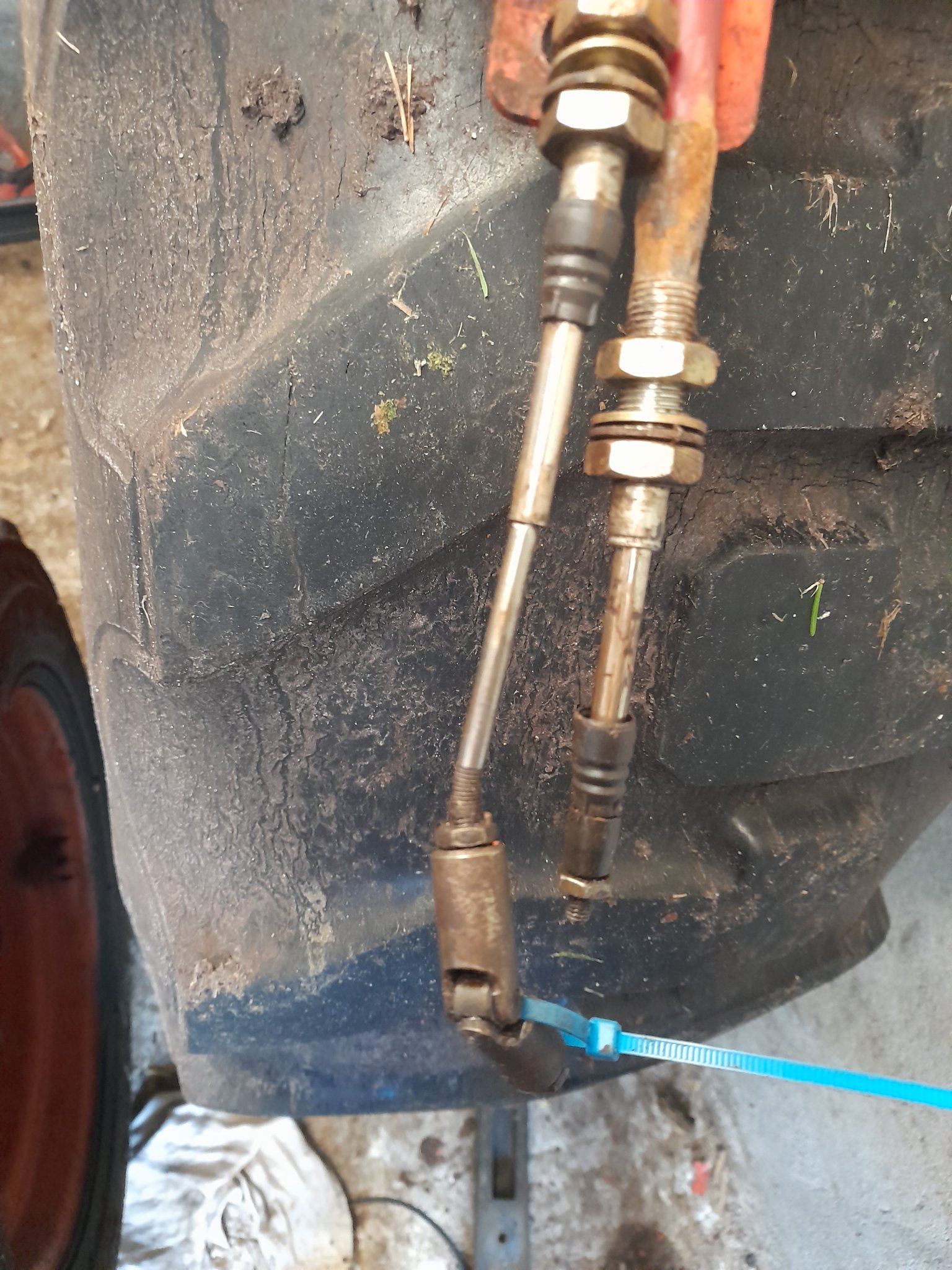

The joystick has the travel, but when it goes forward, it goes to the right. One of the cables is bent, but that might be from trying to force it. Is there supposed to be a rusty ball bearing somewhere?

'bent' cable is a BAD problem.
I'd totally remove from tractor, clean it, oil it,gently push/pull cable several times to 'feel' how it moves
Ireland is noted for a 'wee bit o rain'. If it's got in and rusted the cable badly the following may not work...
if (IF ) it moves fine if laid flat (no kink), you may be able to 'splint' the cable where it was bent, with fuel line hose. This 'splint' will keep the cable from bending at that spot. providing you have room for the extra 'diameter', it should work, fingers crossed.

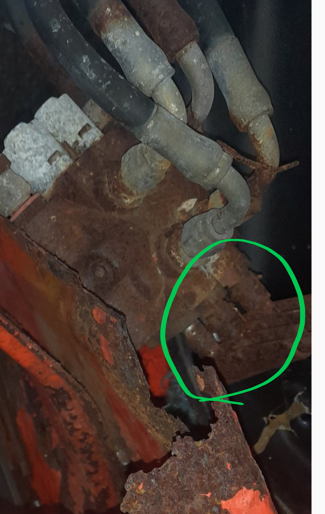

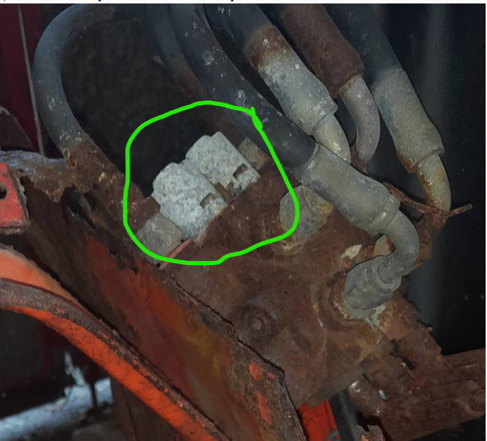

The detent mechanism is in these caps.
There are some small balls and springs involved, so be careful. Judging by the amount of rust on the outside, I'd guess corrosion could be an issue.

@PoTreeBoy go find the coffee pot, if coffee in carafe (If no coffee, make coffee), pour coffee in cup, drink coffee.
You pointed to the control rods not the detents.
These are the detent caps.

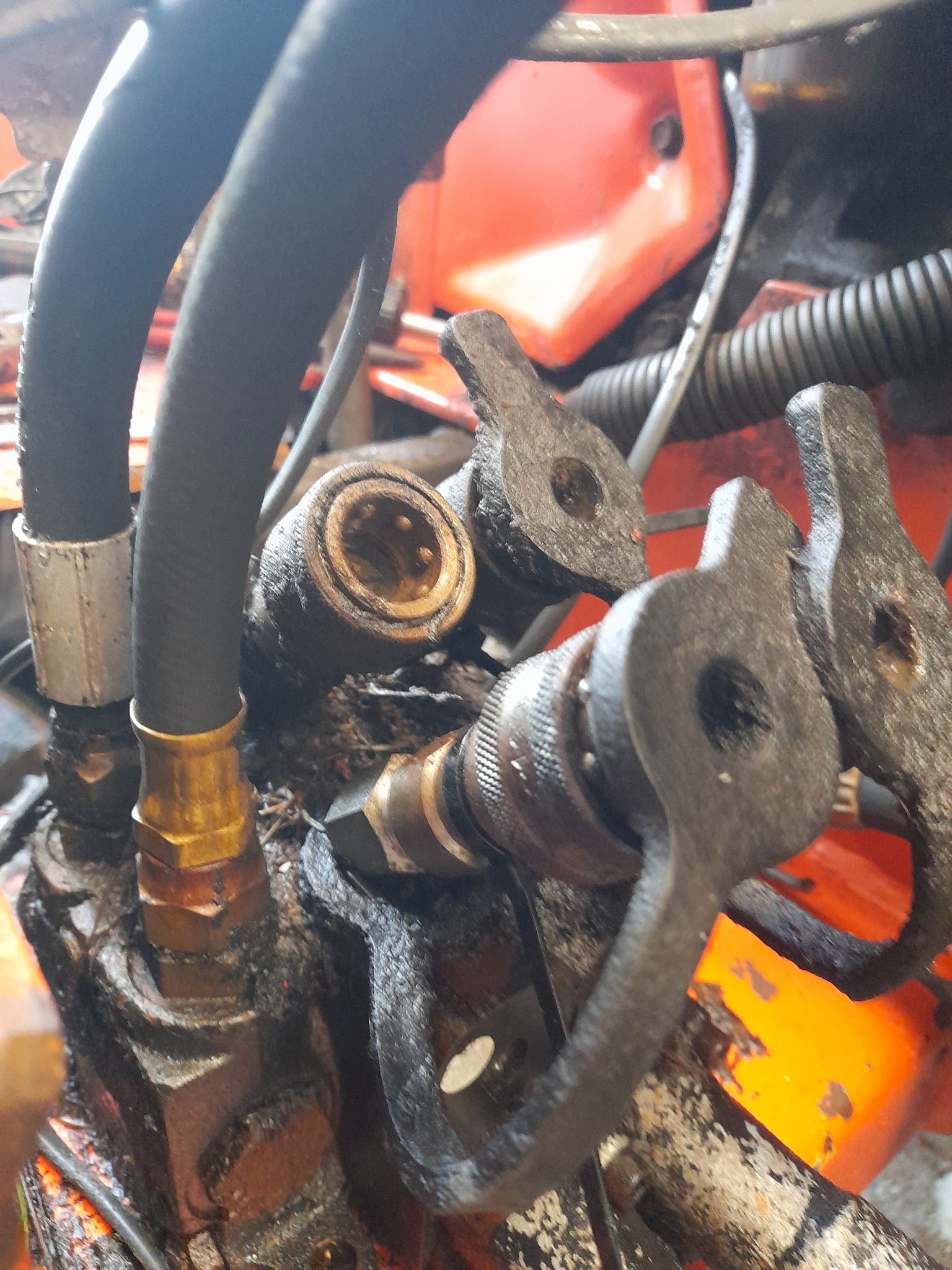

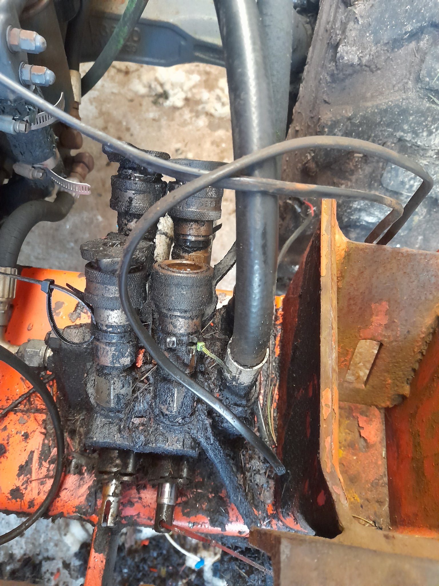

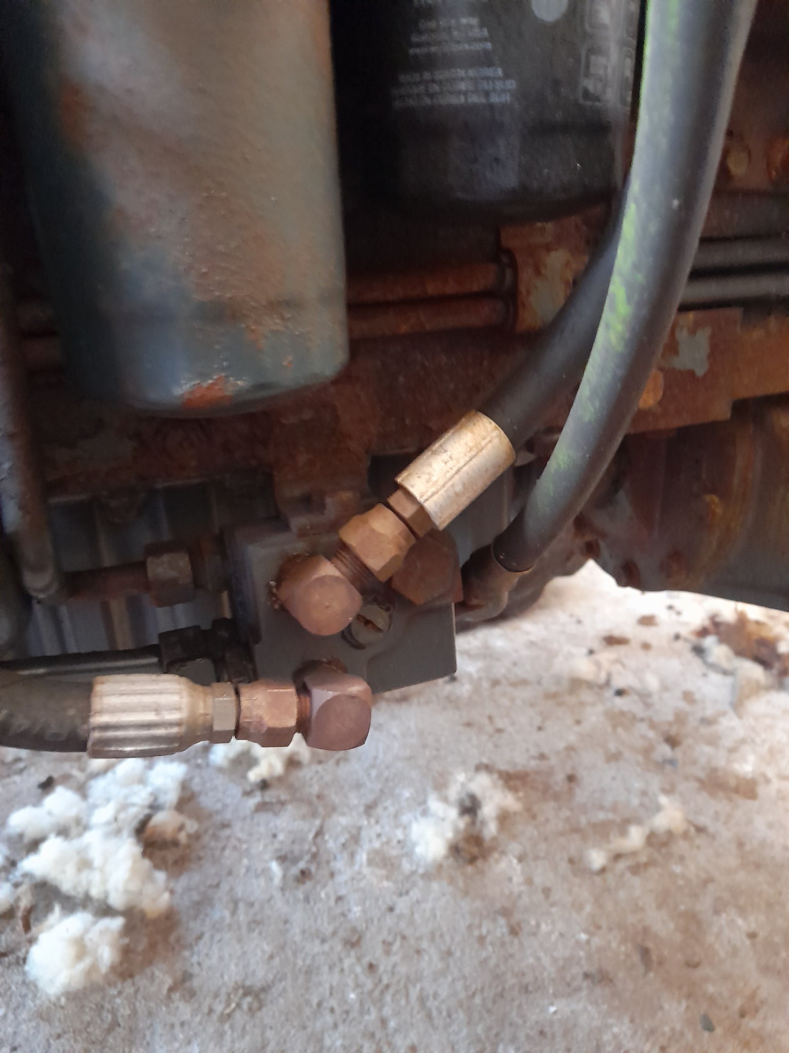

Hi guys, that is the control for the rear spool valves. Below are photos of the loader control valve box and one of the bent cable

OUCH, BOTH those cables are bent ,bad, especially the KINKED one ! I don't know IF it can be saved,even with a 'splint'.
Usually cables or hoses or conduits are NOT bent tighter than 6x their diameter. Old skool 'rule of thumb'. Say cable is 1" diameter, you would NOT bend it more than a 6" diameter, for a 1/4" cable, 1/4*6 = 1.5".
You'll often see cables attached to 'supports' where they change direction. Something like a 'section of pulley', the groove supports the cable, prevent any 'kinking'.
It may be those cables were replaced ,years ago, and not installed in the correct 'path' ? That I don't know but for sure I'd be doing what ever's necessary to prevent kinks !

Possibly an optical illusion. One is perfect. They are just thrown on the tyre for safe keeping. They run in a gentle curve from the fender, under the floor board, and straight to the spool block.

WHAT????
I'm really beginning to worry about your mental state!
Are you looking at the pictures on a watch TV?
The only thing bent is the end and it's minor and 100% repairable.

Give the valve a good bath with orange or purple cleaner (degreasers) and then get me a shot of the front side (opposite where the cables connect) of the detent covers and I should be able to tell you the parts you need to fix the float.

guess I'm looking at the wrong cables...in post #15,there's 2 BENT black cables, right one is really bent.
are they not the two 'control cables' he's talking about that have kinks in them ?
though looking at the 3rd picture , there's an threaded end of one that is 'bent' connected to a long U-joint
