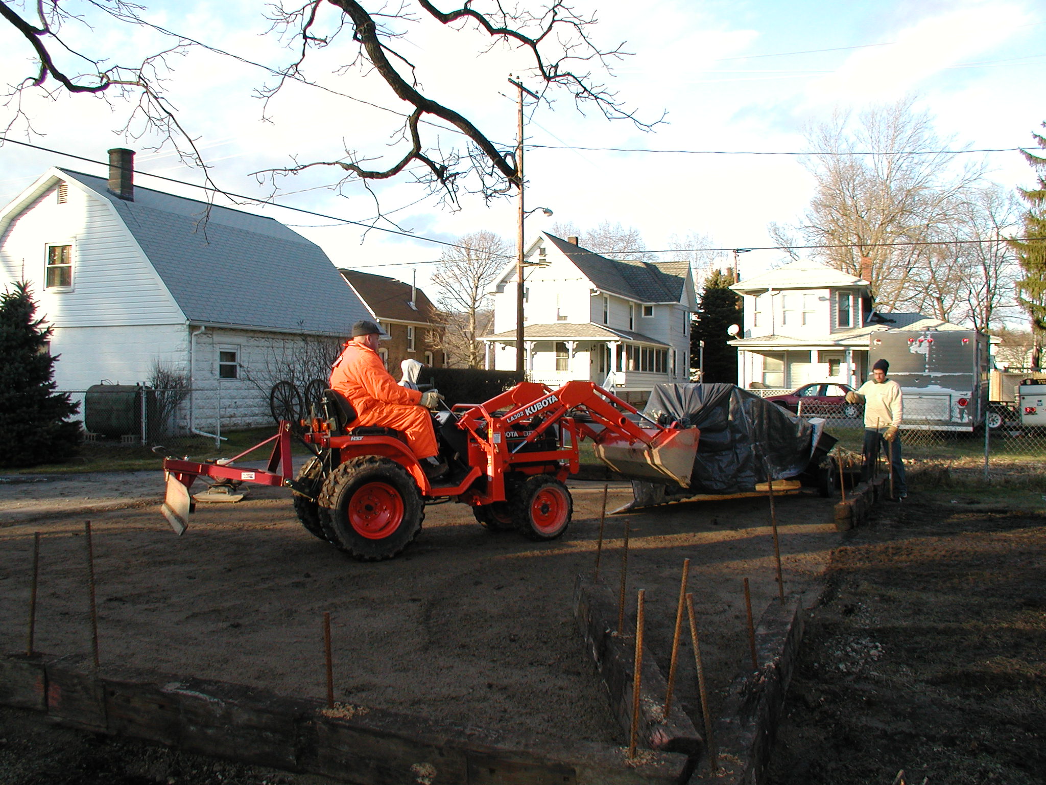

In my experience, no marks were needed to know when the tire on my B7500 slipped. The tractor stopped moving and the tire puked most of the windshield washer fluid ballast on the ground:)

That was 20 years ago and I'm not sure what pressure was in the B7500's tires. As you stated it obviously wasn't enough. It happened in Jersey Shore PA one Saturday while helping #2 Son extend a parking lot at an apartment building.
EDITED - was #2 Son (only have 3 boys:) )
