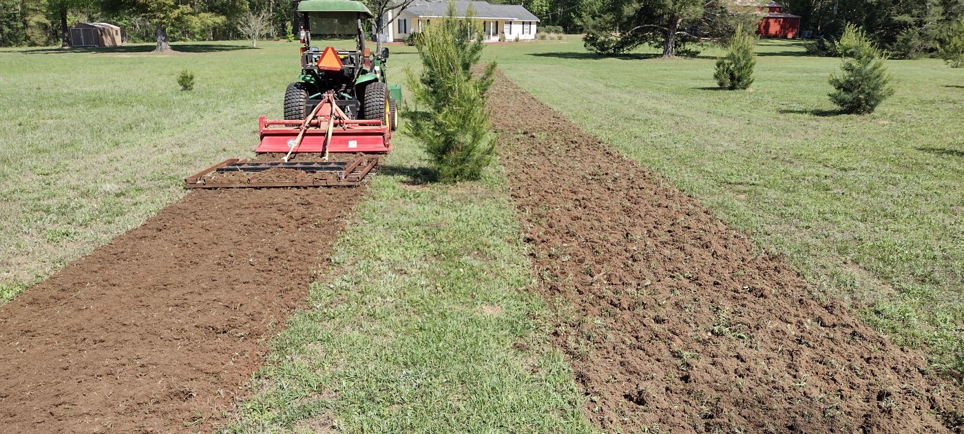

I have also had some luck pulling a drag behind my tiller. The right side of this photo was done without the drag attached.

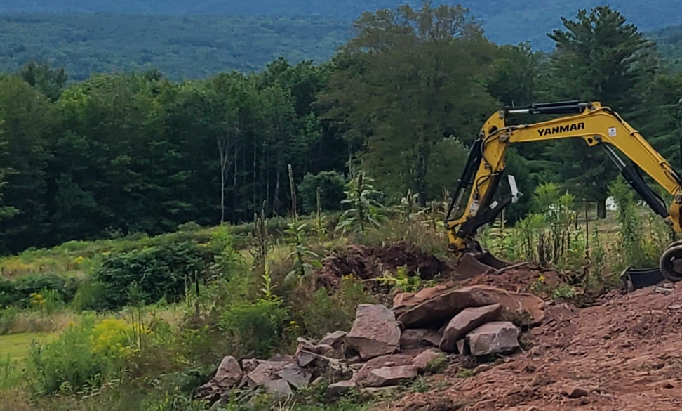

Level a field lol, That is the rocks (only the large ones) that were dug out of a 40 foot long trench for the water line to the house.
Every time you stick a spade in the ground around here you hit a rock, maybe its the size of a baseball
or maybe the size of a car. Like a box of chocolates, you never know.
I have 3 fields that are somewhat smooth and I would like to make them a little easier to mow but
whenever you try to grade an area you find more monster rock(s).

That’s what rock picking is for. We had fields with mountains of rock piles around them. Some piles had bigger rocks than in your picture. When we reseeded the hay fields, we would work them smooth, spend days picking stones, reseed and hope to get 7-10 years out of a productive stand of grass/Alfalfa mix.
