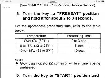

so here is a few things I want to find out 1 does the diesel have spark plugs that can go bad ? is the main function of the glow plug just for temperatures be low a certain degree to warm the fuel so it will ignite? other then that it doesn't have any thing to do with the starting of the tractor, or if blown will it allow it to turn over but not start even though it is not cold out? and is there a certain type of oil I have to use in my 2230 tractor other then car oil? if anyone can answere these questions I would greatly appreciate it thanks

glow plugs can be needed all year long - more used in cold weather.....I have two engines that need a little glow to go every time unless hot!
thanks so this problem could be a glow plug issue ?
