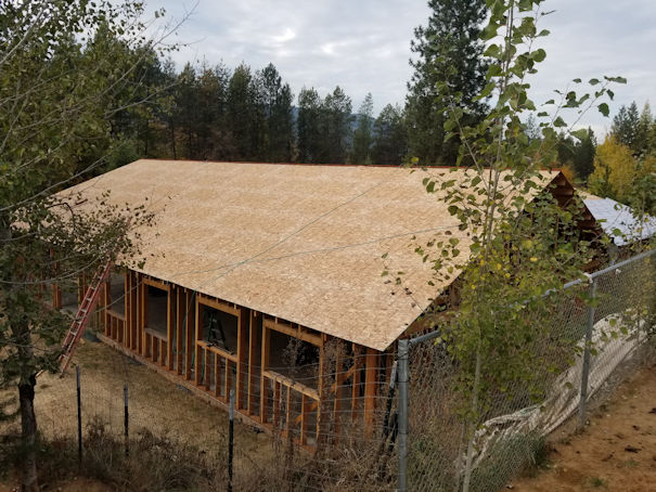

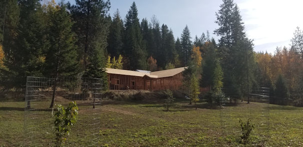

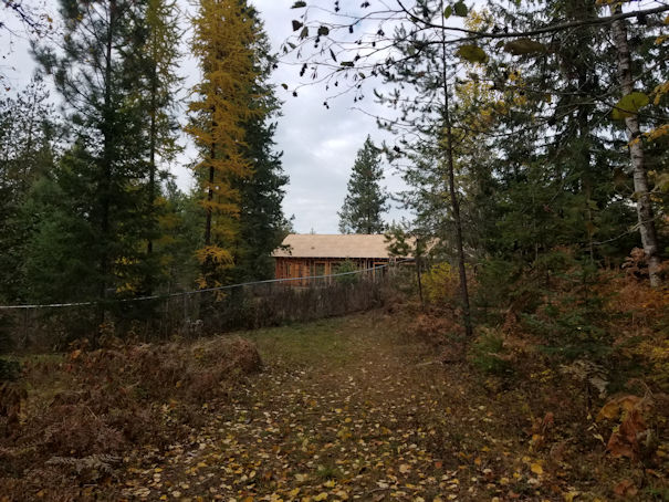

This to this in 7 weeks into it after pad was finished (79.5 cubic yards of concrete), 2,520 SF house and 1,050 SF garage.
We wanted to get into it before winter hit but fall weather did not cooperate, so now we are shooting for late spring early summer move in.
https://www.orangetractortalks.com/forums/attachment.php?attachmentid=46768&stc=1&d=1579195924
These pictures were right before we temp wrapped the outside for winter.

Once again, nice place. I'm assuming you have a few deer in the area seeing that your trees are wired in. Gonna be some happy dogs living there.

White tail deer, Mule deer, Moose, Elk, and a whole bunch of other critters, gotta love the wildlife!
Yea our wolves, wolf/dogs, and dogs love it here, they have quite a bit of fenced yard, 2 acres give or take right now and will double that once the house is done.
we want to fence the whole property but that's pretty pricey!
We also do property runs once or twice a day in the spring, summer, and fall (back of property is 4+ feet of snow right now so that's a no go area), all but three of our kids are lead free, we don't want them getting into trouble, so they only get lead walks!

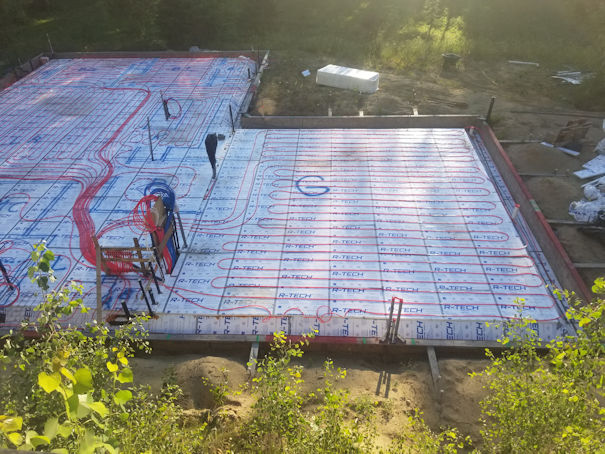

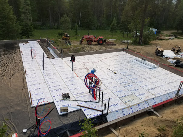

That is a bunch of cement, Im wondering, do you have hot water pipes or heating elements in the floor for heating? Yes sir that is a real nice looking place :D

Yeppers full hydronics, with pellet stove backup, house and garage, 12 Zones, all sitting over 2 inches of foam all around and up the sides of the pad.
Garage is sloped to front gutter drain (red strips, in pics 4 and 5) so pull frozen truck into garage and it will melt off overnight.
The garage skirt and front sidewalk will also be hydronic heated, but that will be a glycol system and heated via a geothermal loop 16 feet in the ground.

Ah yes, oxygen barrier red PEX, I know it well. My entire shop floor is heated but I use Cryotek fluid in mine, just in case. Non toxic. (supposedly).
