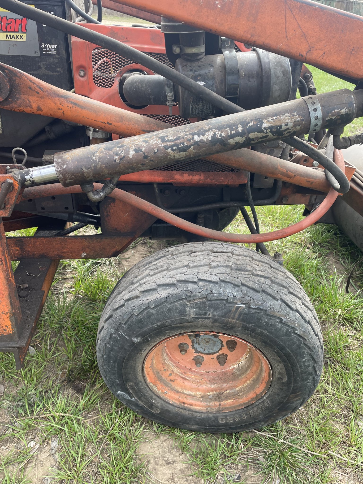

Good afternoon, fellow Kubota-ers.

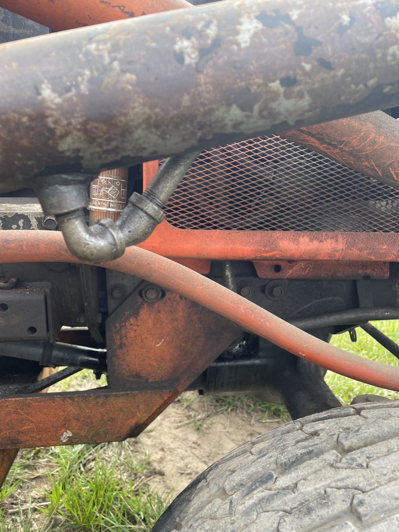

I’ve got a 1984 Kabota B 7200 and the hydraulic cylinders have been rebuilt, but a friend of mine put them on for me and I don’t know if you put them all right it’s one of the couplings is leaking and I’m attaching a picture so you guys will know what I’m talking about. I don’t know whether I need to take it off. Check the O-rings in or what if y’all could let me know something I would sure appreciate it. Thank you.

Ouch, well where do I start..
First of all you should NEVER usse galvinnized pipe fiitings for hydraulicss, as they aree not rated for the pressurre.
there are no O-rings on those fittings they are just a taper fit fitting.
That way of hooking up the lines does not allow for the liness to be properly connected and ttigtened.
It nneeds the right fittings to be used.
And the fittings do not appear to have any pipe dope on the threads so there is even less chhance that they will seal.
It's also very likely that the NPT fittings are not the right thread for those cylinder connections.
They could very well be BSPT threads.
They could also be a straight thread that should take SAE O-ring boss fittings.

First thing need to know, are they the original cylinders that came with the loader?

I just looked and the fittings for that loader cylinder should be the one that I put the picture up on.
Need to kn ow the connection to the Lines side of it to know if that end need to be female or male.

The common NPT (pipe threads) of those galvanized fittings …also may be of such a mis-match….as to have damaged the threads in the cylinder…. making that re-seal-job worthless if the threads can’t be repaired.
(I have to say, however, I know many of us have seen some unique “Farmerized” tractor repairs not too different from this, tho‘.)
It bears mentioning to the owner, that when working on hydraulics …especially those that leak…. One should keep your hands away from the fittings while they’re pressurized.… because the pressures involved can inject hydraulic-fluid into your skin and cause serious infection-damage.

Thank you very much. I did not put those hydraulic cylinders back together. I had a friend do it that supposedly knew about diesel tractors and the hydraulics but apparently he didn’t. I will get some of those fittings. I learned so much from you guys and I really do appreciate your help
