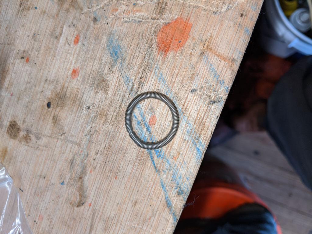

Sorry, but I'm here to revive my own thread! Finally getting around to fixing my hydraulic leak. Found it coming right from the 3point lever assembly. Got it apart and I'm confused, I bought the right gasket according to the spec sheet (see photos), now I'm wondering if someone changed something, or if I'm just a dummy. Please help!
1- Reference part #090 doesn't appear to be here, it's listed as a spring... Do they mean like this (see pic)
2- There are gaskets on the shaft control levers already, and they appear to be in good shape. The gaskets I purchased are much larger. Are they intended to go on like I have them arranged below in the picture? There appears to be no part # for the O-rings on shaft control levers.
Thanks!!!

I'm thinking I got the wrong gaskets.. ordering new ones along with the "spring" I'm missing. No idea what it really looks like as the only website that stocks the part has no image. Will post end results when I get the parts in the next week or two.
