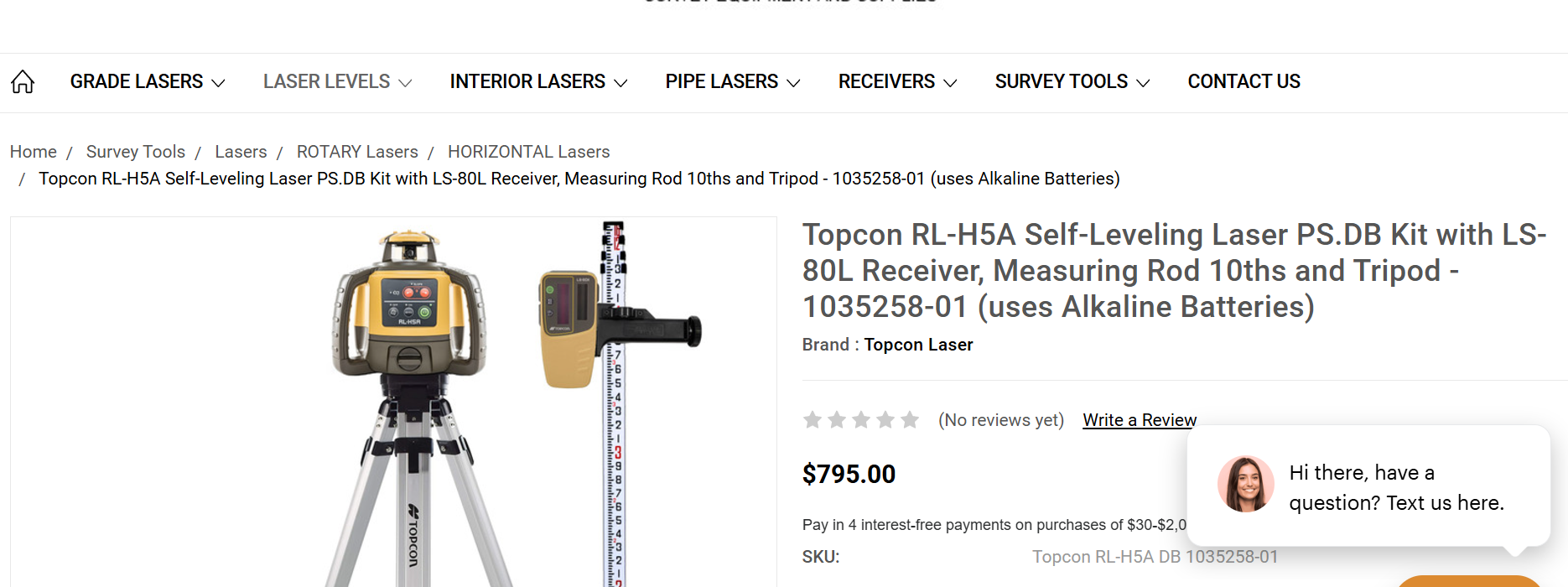

I know it's overkill for your use, but I have one of these and you don't "see" the laser, it's done with a reciver that see's the light and tells you up or down and level.
