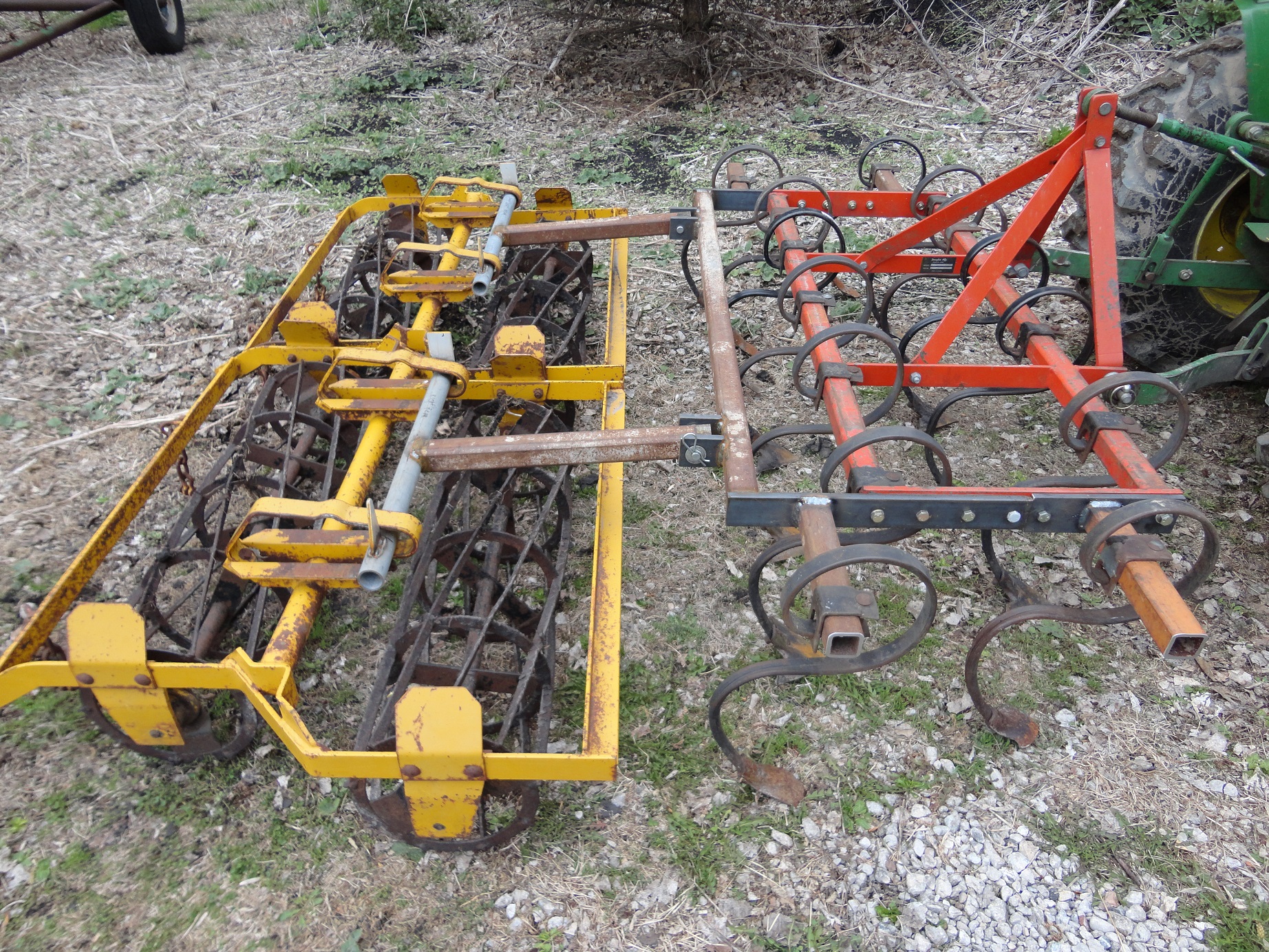

For many years prior to a roto tiller, this was my cheap (less expensive) way to cultivate and prepare a seedbed for our 3 acres tillable ground. All was picked up used at auctions or just before they hit the scrap dealer.
This setup was used behind my older 20 HP JD750 MFWD tractor.
The rolling baskets added to the rear of the s-tine cultivator does a fine job of breaking down the clumps and leveling the loose ground behind the cultivator. I added some "wings" to the cultivator to match the width of the double baskets. The rolling baskets would get removed once the seed bed was prepped.
Once the crops were up, the s-tines and shovels would get changed around for cultivating between the rows. For not much money (if you're lucky to find used) this setup works very well. A spring tooth drag section pulled behind the cultivator works well also.
If you have a junk dealer or metal "clean up" person nearby, it might be worth looking into to see what they might have ready to go through their crusher and to be sold for scrap metal.

Nice rig. I have bin looking for squirrel cages have not seen a small set / big farm stuff only.

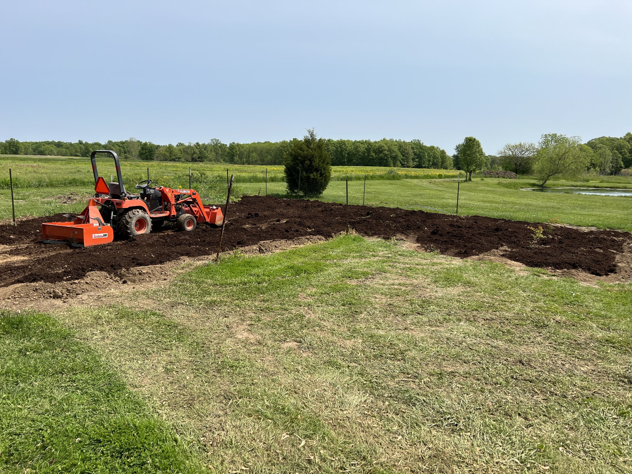

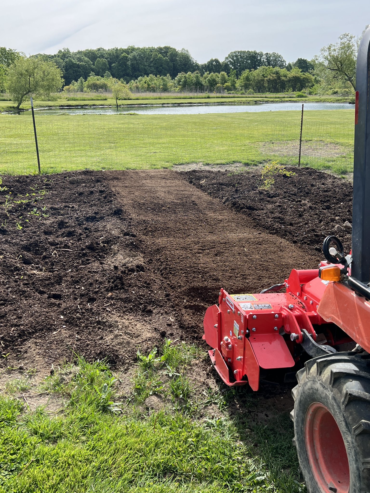

For a tiller I rent one from my local Kubota dealer/Farm Store. It is $100. I pick it up Friday after work and return it Monday morning. It does a really nice job and I would love to have one of my own, but since it is a use once or maybe twice a year for maybe and hour type of attachment for me I can't justify the expense.
As far as the depth of the tilling. There are a lot of different thoughts on it, but I am in the shallow tilling crowd. That is unless you need to till deep for a specific reason (dug things out and brought in soil/compost to mix).
I spread a bunch of topsoil and compost this year and then tilled it in, but not too deep since I was trying to not disturb the clay bed I was covering.

Is that top soil or cotton dirt? If it's cotton dirt be aware you will fight weeds for a while but in the end it's ok.
It is topsoil with compost tilled in.
I brought in 22 tons of topsoil. Then topped it with 6 yards of compost. Tilled it all together.
Hoping for good results. Each year I try and add a little and increase the quality of soil. I started with nothing but clay.
