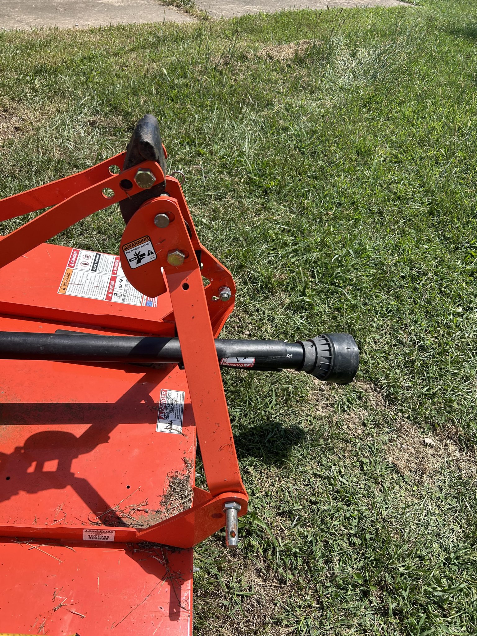

Does this look normal? I purchased my Kubota with this rotary mower, and ever since I've had trouble attaching it, I put a quick attach on and more of the same. It just doesn't look right to me, I've watched you tube videos and still..... The rocker on the top does not rock, it's horrible, makes me use my belly mower to bush hog.

Good day. To me, it looks like where the top link connects to attachment needs to be rotated forward to allow the just behind/above (black casting) to drop back/down. Maybe there is a bolt too tight or corroded preventing the hitch point movement. Might need a little lovin’ if you can’t get the link arms attached to the pins. I think once you have the top link pin aligned vertically with the lower link pins should be a lot easier to install. (Seems sorta odd that it would have been disconnected at that angle though?)
