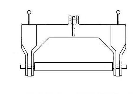

Unless you have an implement with a narrow frame and long pins, the implement can't side shift and drop one side out of a quick hitch.
With knobbed bushings, the implement probably can't shift enough for the knob to touch the quick hitch.
Linch pins are needed to hold the individual bushing in place, but the quick hitch probably never bumps them. They could be removed and the implement still can't fall out.
In the diagram below, the top "triangle" of the hitch has been removed for clarity. The lower pins and frame are shown in the quick hitch, without knobs or lynch pins.
Imagine trying to move this lower frame sideways to the right until the left pin falls out. It can't. The frame hits the hook and stops.
