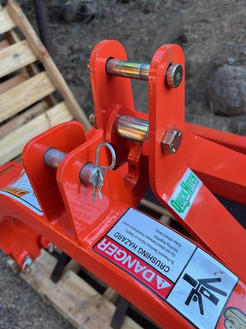

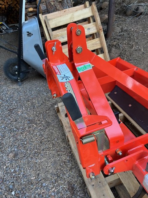

I picked up a Land Pride QH05 quick hitch this morning. Went over to another dealer to see if it would fit a 48" box blade from a differnt manufacturer. Everything lined up perfectly as far as width goes, the side/bottom pins sat perfectly in the quick hitch. Only problem was the center pin with the collar on the box blade didn't sit all the way down into the top center receiving portion of the quick hitch. It' only went about halfway down into the receiving portion of the quick hitch.
My question is, is this still acceptable, or is this a problem and should I avoid this and jsut go with a different box blade that fits better, or is it not an issue since the two bottom pins are seated perfectly and lock into place on the quick hitch?

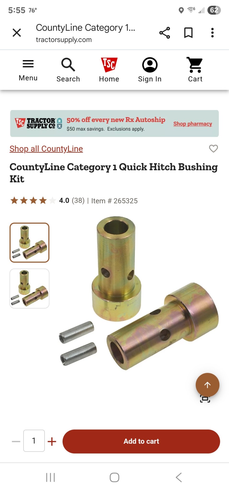

What I would wonder is whether there is any slop between the pin and the hook to put a bushing on the pin to take up some space and fit a little better?

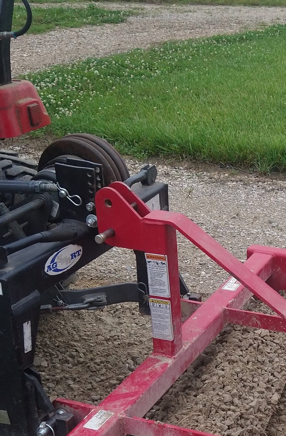

There are different types of 'attachments' that are used on attachments like this U bar thing i use here on my bushhog to mate to the quick hitch. So there might be another connector to make it attach.
I also bought bushing that I put on all my implements that the quick hitch snaps onto.

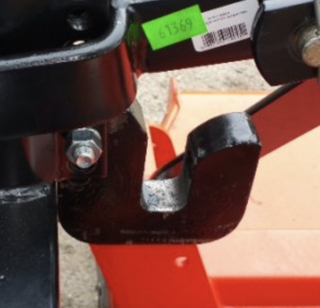

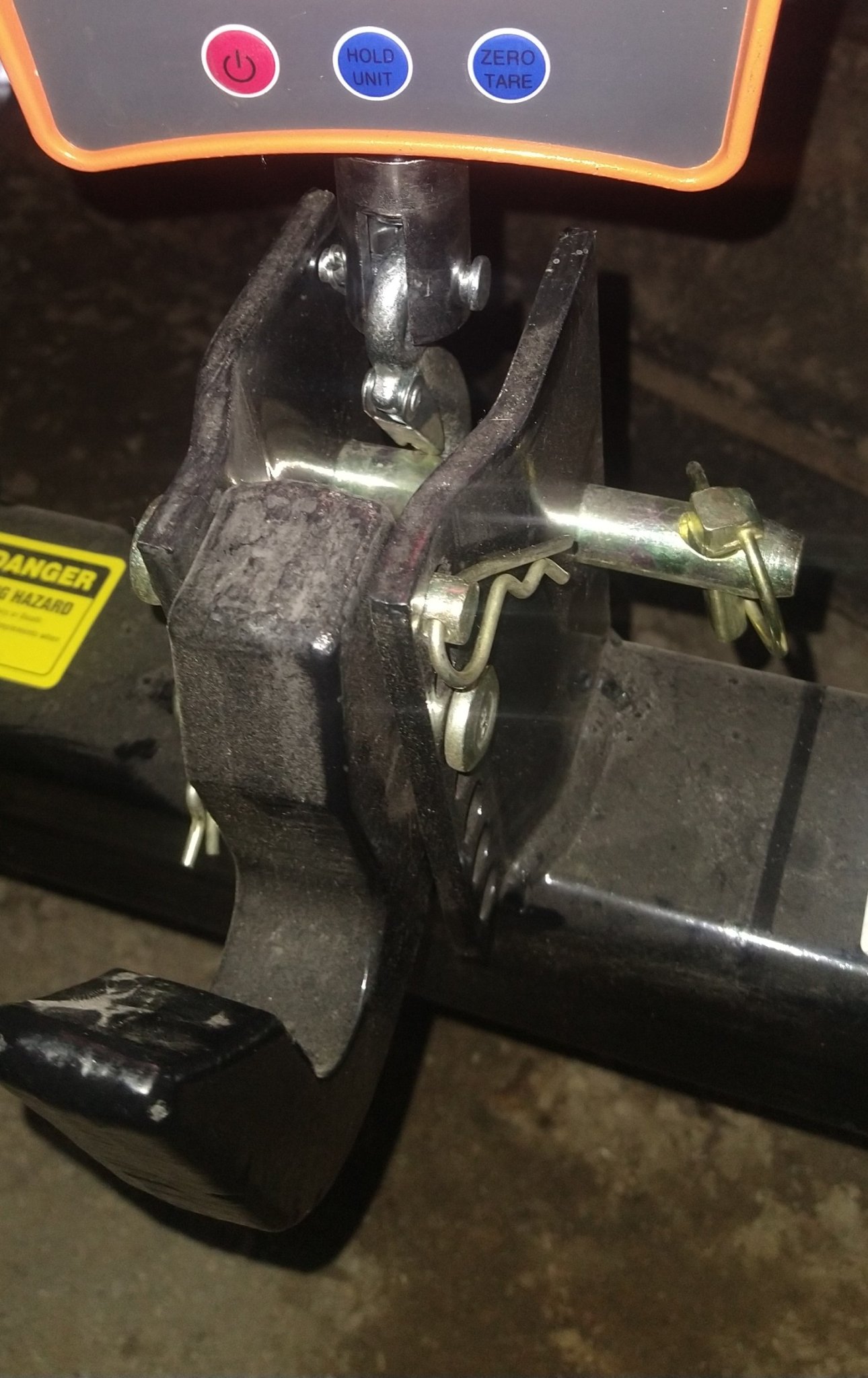

Taken from the image above, this is the part of the quick hitch that's in question. The top pin with the bushing over it on the box blade sits down into this channel about half way, but doesn't seat down completely, while the two lower pins line up and do lock into place.
Well I’ve never used a box blade…so there’s that☺. But would think that if the pin is below the top of the hook it might stay in. If there is a chance the pin could pull back and over the hook, then I would tread lightly. I would think a ground engaging implement would need the hook to prevent the pin (implement) from rotating back. (I would not want it to pull out of the hook if it were mine)
if the hook would prevent rotation of the implement, and the lower link pins are secure I would think it should hold. Keep in mind nothing locks the top link…it’s just helps secure from rotating back by the hook…prevents the implement from flopping.

The QH05 has a fixed - non-adjustable - top hook. The QH16 has an adjustable top hook.
If I remember correctly it was recommended to M-Tiger to get the QH16 in another post.
