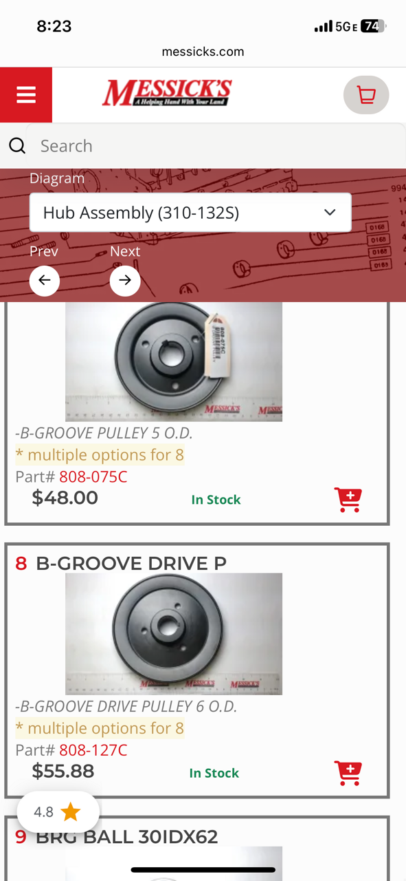

Messicks shows a 5” and 6” pulley. Looks like the bores are different as well. Website doesn’t list any specs.

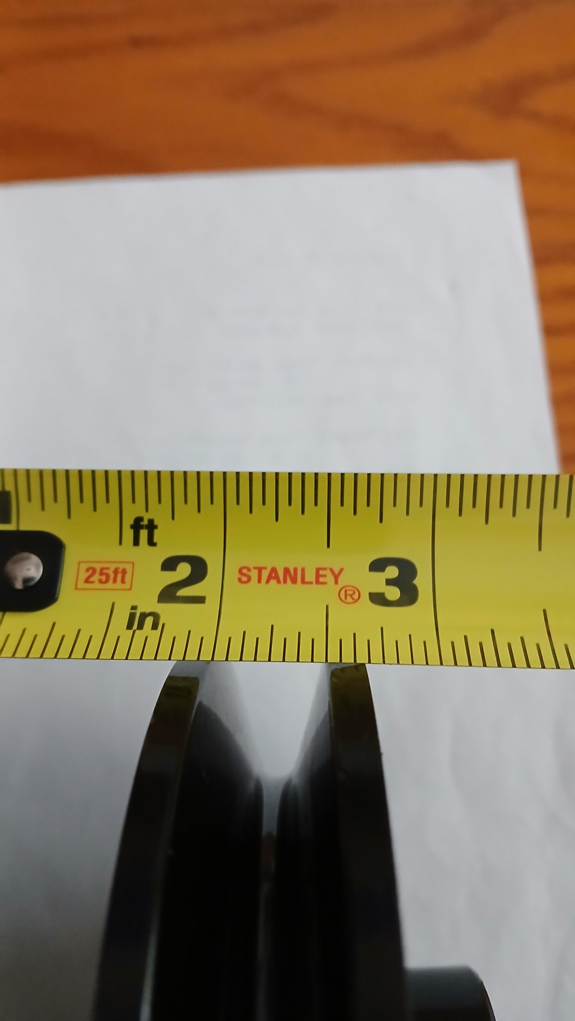

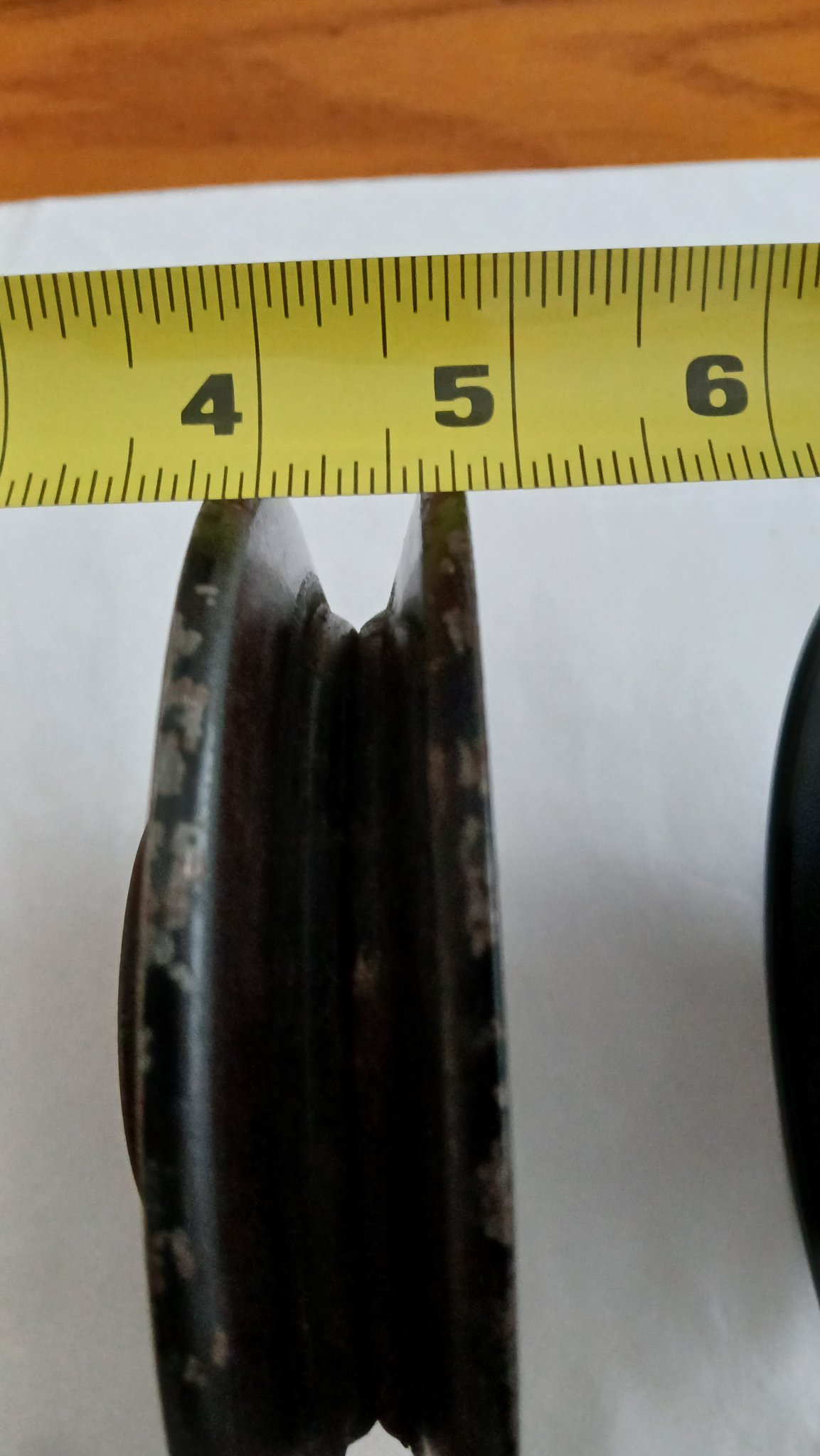

I have included pictures below. The 1st pic is the original pulley and the 2nd is the new one. The inside width of the original is a hair over 5/8 with a rounded shoulder and the new one is a hair over 1/2 with a sharp shoulder at the edge. They are both 5 inch in diameter.
As you can see the new pulley is meant for a 1/2 inch belt. If I were to use a 5/8 inch belt on this it would wear a groove into the belt at the edges and then not make proper contact with the rest of the pulleys.
Messick's website has helped to some degree in showing that none of the mowers that this spindle assembly is meant for uses a 1/2 inch belt yet I received a 1/2 inch pulley.

That looks like a B section sheave to me.
Whoops - I was looking at the old one 😡
Whats wrong with Messicks?

Why dont you just buy their pulley?
Because when I spoke with Messicks they could not provide me with any specs on the pulley so I might have just gotten the same one I already got. My dealer had said that Kubota does not have any other types. I also wanted to give my dealer a chance to get me the right pulley first before going elsewhere.

You can buy a 5" B section pulley with SDS bushing for about $80.
Quick-Disconnect Bushing-Bore V-Belt Pulley for a, Ax and B, BX Belts, 1 Groove, 4.95" OD
