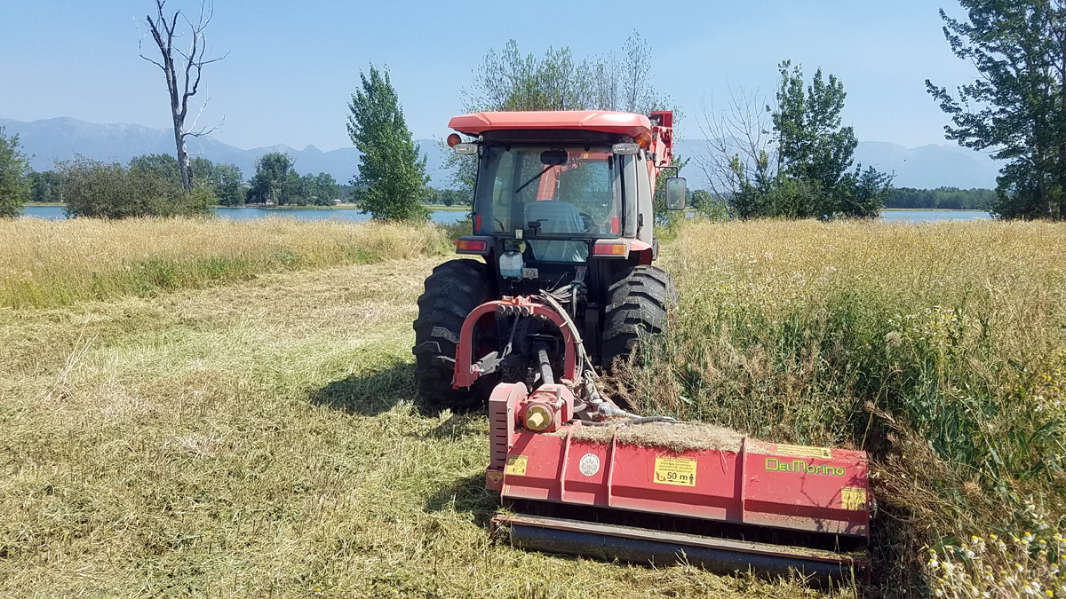

I'm not trying to monopolize responses to you, but as it turns out, I do a lot of flail work with the MX6000 and a Del Morino Centurion Super 158 flail. I will say that I cut some fairly thick and tall stuff but never run the flail off the ground. I'm not saying that it's a bad idea necessarily, but it does put a lot more stress on the rear of the tractor, particularly if you're bouncing around. Flails aren't really designed to be run with the rear roller in free air ... at least that's my opinion. That said, I can rotate the cutting head on my flail to a little past vertical and offset it for hedges or similar, so maybe it's just fine to run it raised off the ground. But there's no doubt that the stress on the rear of the tractor is greater if the weight is unsupported. I guess the question should be whether or not that matters.
I'm not familiar with guinea grass and albizia trees, but I cut as fast as the vegetation and ground condition will allow, so if that's 1mph then so be it. I would try to stay within the max PTO shaft angle listed to increase the longevity of the u-joints. Also, the flail will run a lot smoother if you can keep the angle as small as possible.

I think @McMXi covered it.
But my 2 cents:
Do not run and operate a fail off the ground.
It's not a good idea, just take it slow.

Points well taken in regard to not operating the flail unless the roller is firmly on the ground. I need to check to make sure the roller is positioned at the location so the flail is high as possible.
I choose the flail over the brush hog because it seemed the flail is much more durable.
