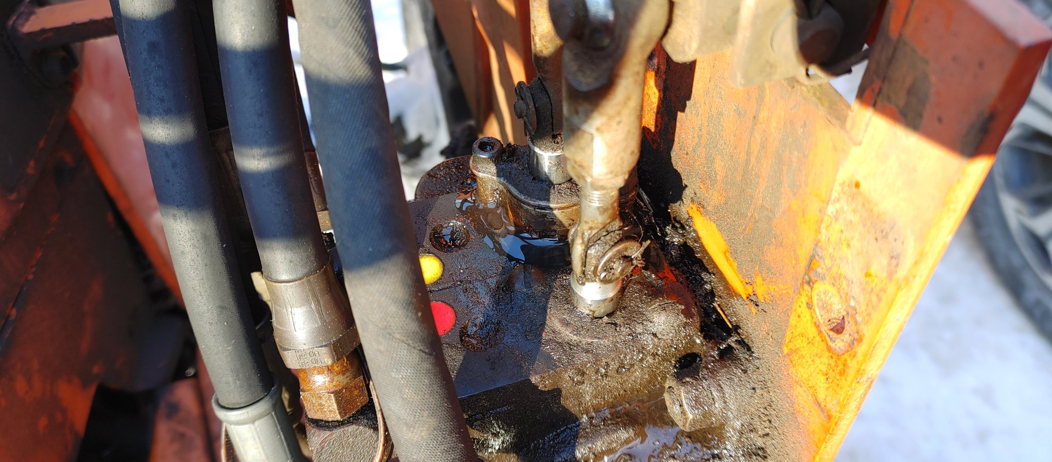

Lost curl control on the loader, and then noticed I had a decent leak at the raise/lower valve. Not spraying but definitely seeping at a decent rate.
What is the repair process here, clearly I need the "seal plate", but should I plan to also get the spool seal kit?

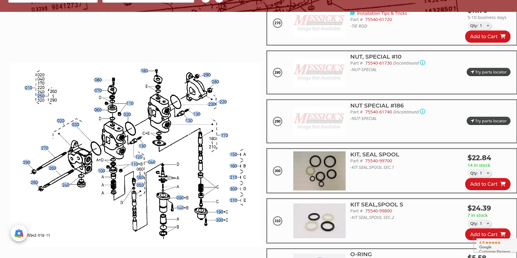

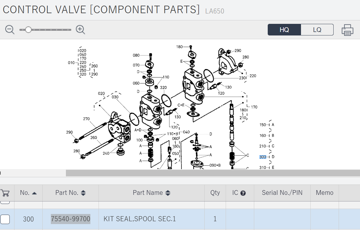

Looks like a bunch of o-rings under that seal plate/spacer are labeled 'D', which looks to correspond to the seal kit 300, if I'm reading this diagram right?
Screenshot 2025-02-22 at 12-33-26 Kubota LA650 (FRONT LOADER W_O BUCKET) Parts Diagrams.png
31,703
7,495
Yes that's the seal kit you need, I would get the other seal kit and do both spools while your in there.
Seal kit: 75540-99700
