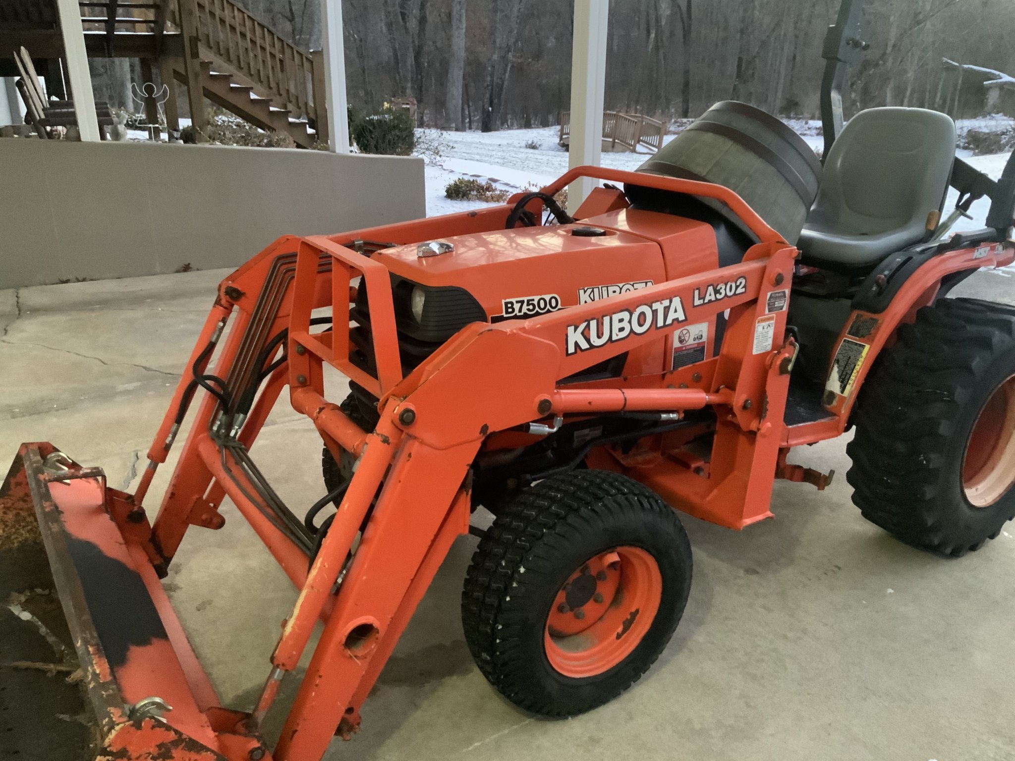

First time owner of a Kubota tractor. Single digit temps and trouble starting. Turn glow plugs on and can get it to start, but cuts out. is it way too cold?

So the LA302 refers to the front loading bucket I have on the front? Thanks for extra info about the tractor.
It isn't just the bucket, it is the whole assembly, the arms, bucket, hoses, valve, etc.

The LA302 is what they call the FEL (aka Front End Loader).
