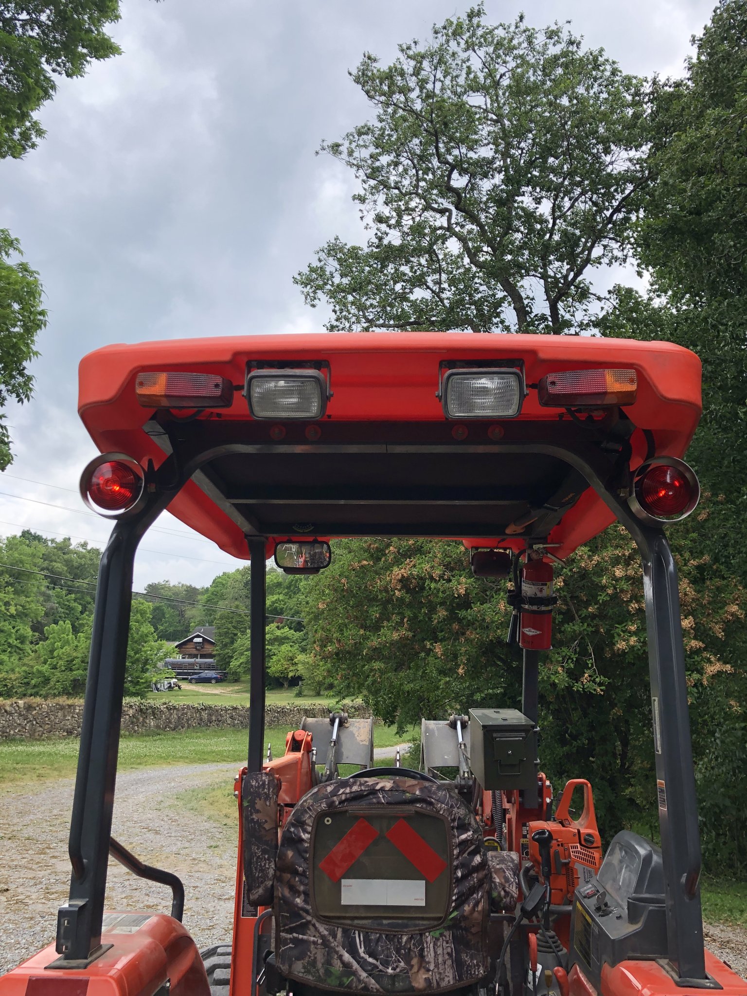

New L6060 owner and bush hogging in woods today lost the lenses from both lights, one bulb and separated wires on one side from the two turn signals on the back of the tractor. The small rounds ones on top of the cab in back.
Two questions: 1) can you buy just the lenses. I have looked and can't find the correct size and 2) anyone ever just remount these lights upside down on the brackets so they are less exposed? Right not they are a setup for a branch to get between cab roof and the light and cause damage.

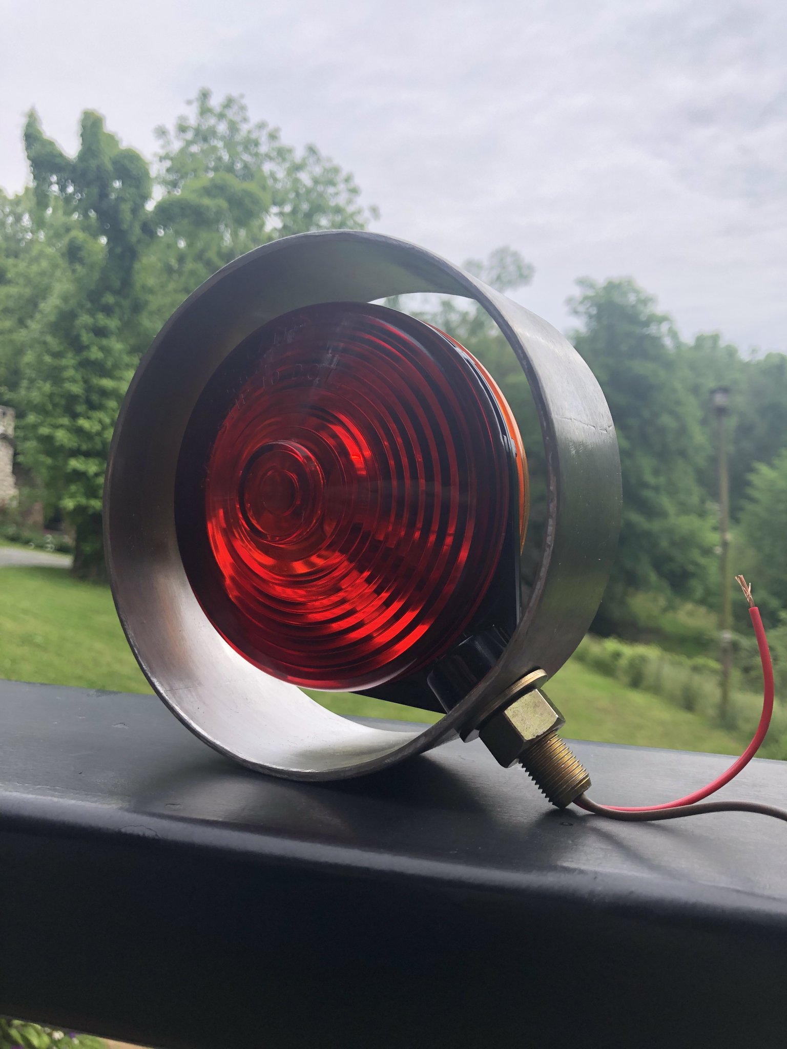

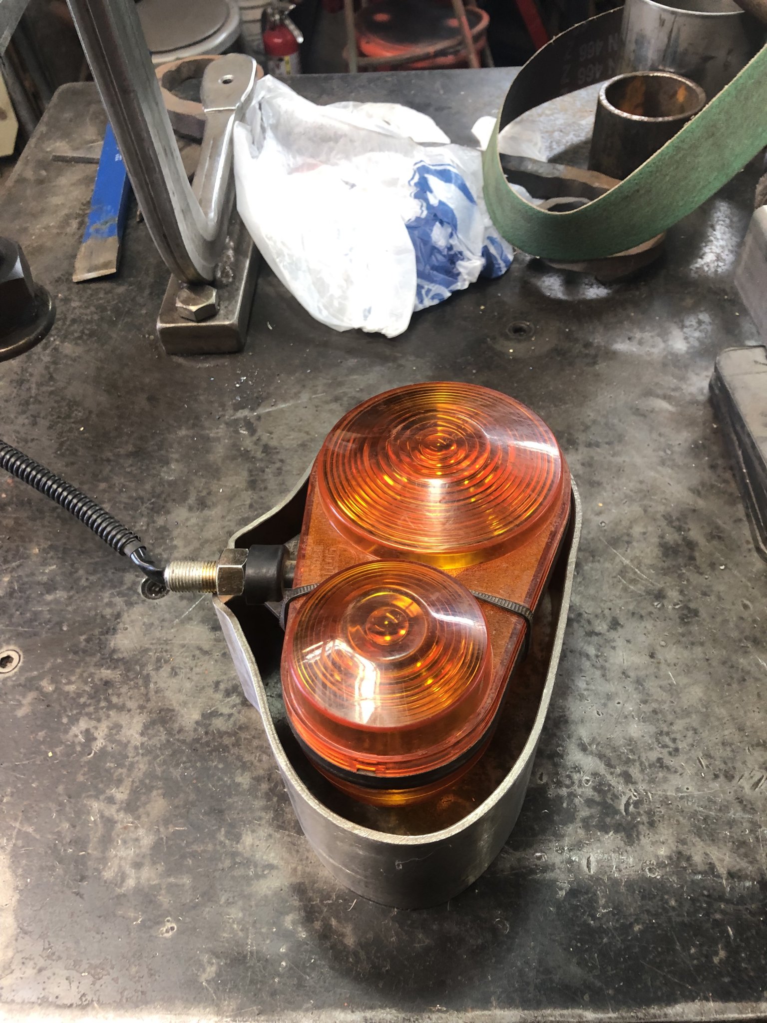

Lost lens and lights from working in woods. Made protectors from SS tubing found at junkyard. Use nylon wire tie around lens. Haven’t damaged or lost lens since.

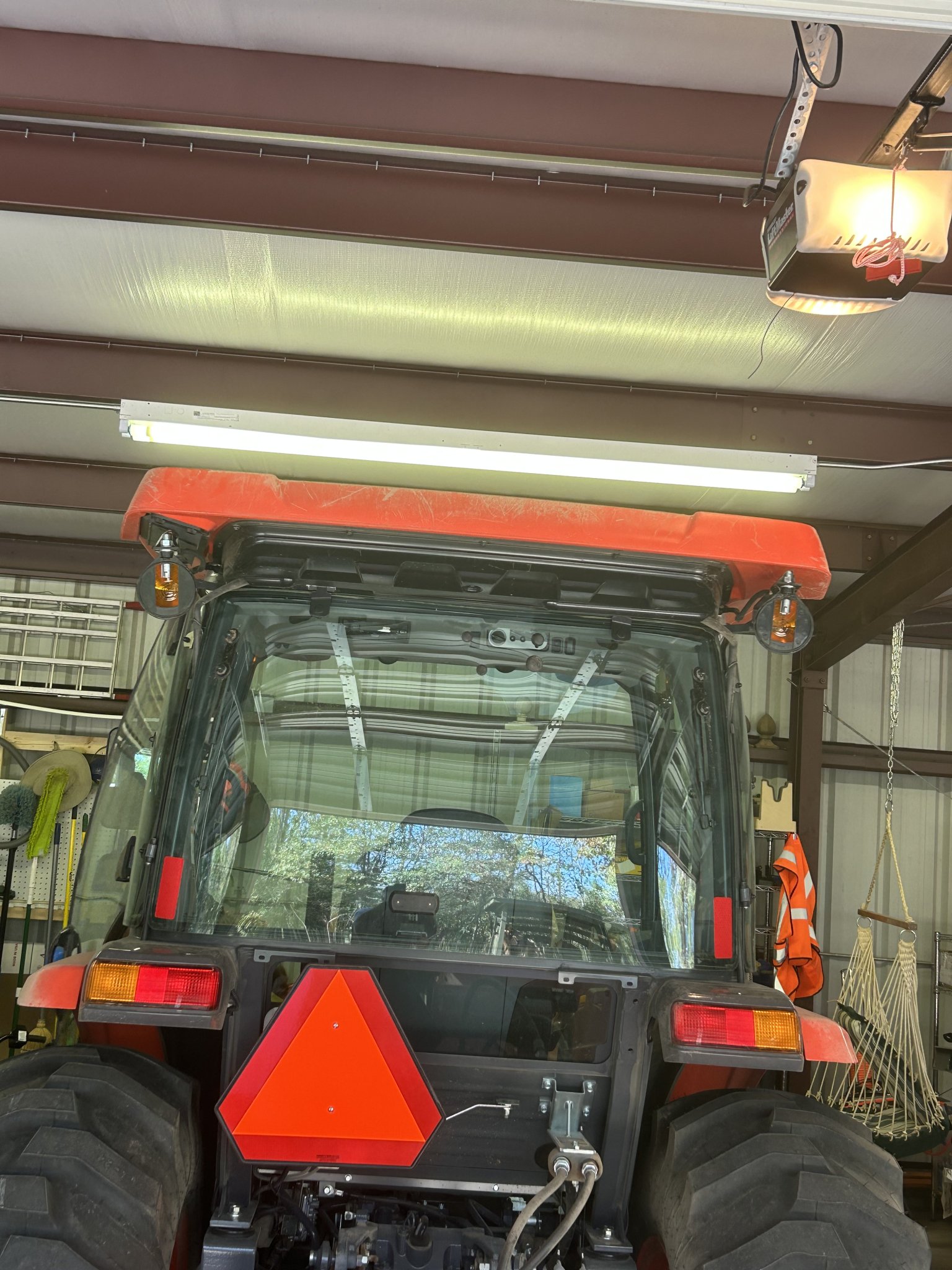

This is how I have addressed so far. I reinstalled the lights upside down and moved in board. Wires now on top so to protect them I duct taped them down. Found 3 of the 4 lenses so now have to order one lenses and one bulb.
