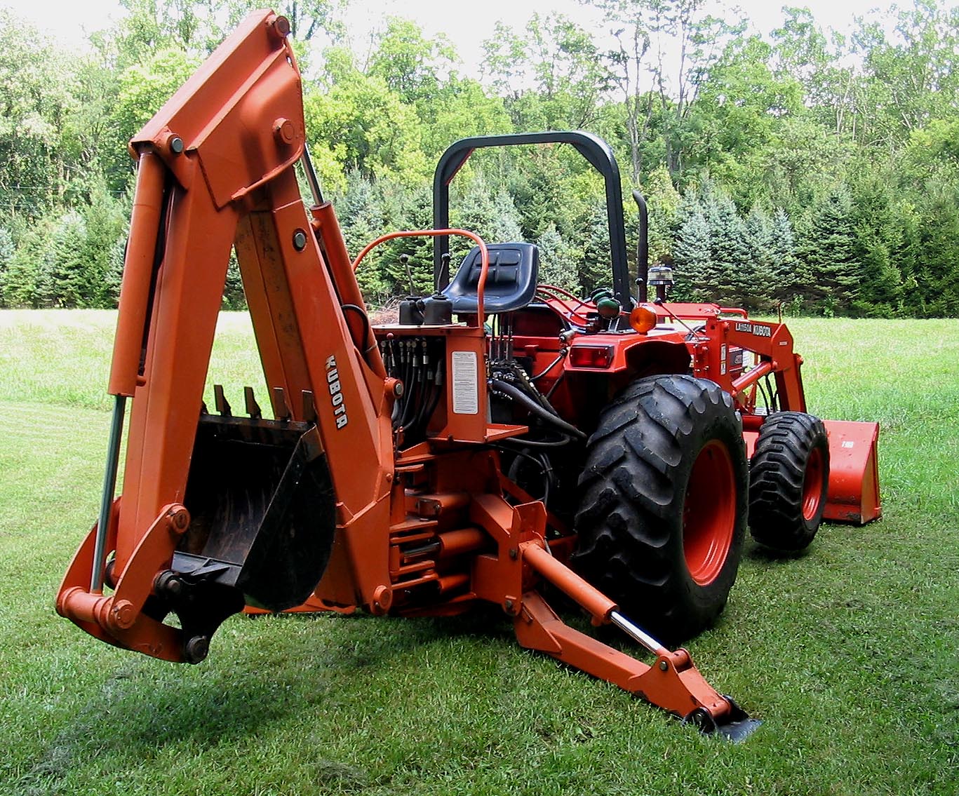

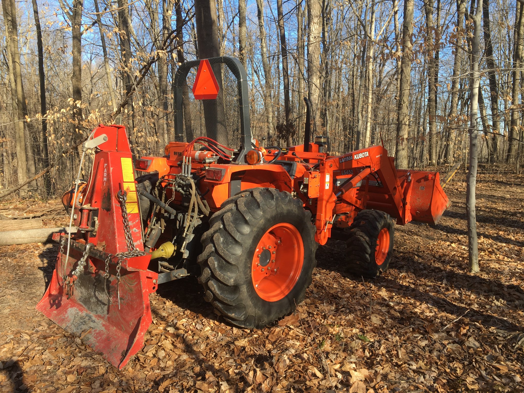

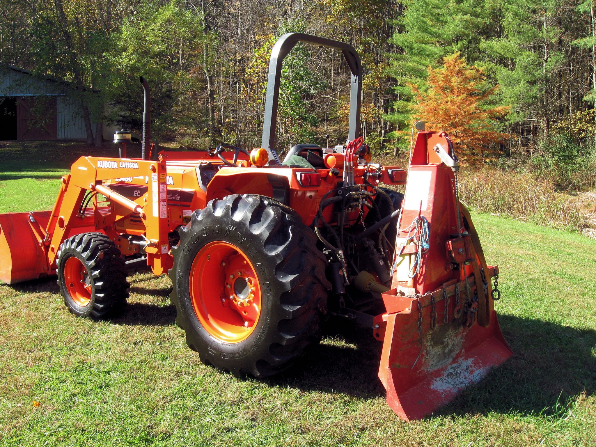

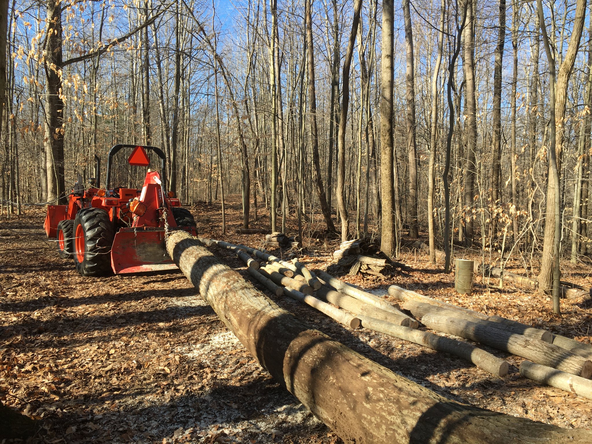

TREE GUY ! Great to hear your voice ! Love the pictures of the best-looking L5450 on planet earth!
