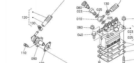

My guess is you have a failed or weak lift pump(parts key 090). If it was my tractor I'd install an electric lift pump. I agree you should check for good fuel flow from tank.
