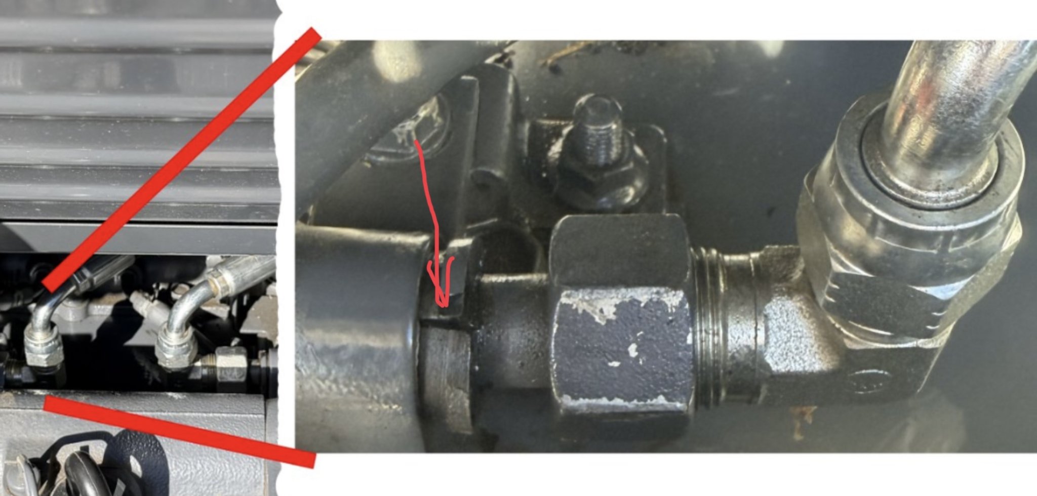

As I began to use the grapple, I noticed hydraulic oil on the pavement. Thinking the third-function valve was leaking, I tightened all the connections. The leak eluded me.
I narrowed the leak to a connection just above and behind the transmission fluid dipstick/fill cap. The photo below shows the general area with an inset photo of the L-shaped connection. In the inset, notice the gasket to the left of the large nut in middle. I believe the leak originates at or near this gasket. I confirmed by placing a piece of cardboard just below each L-connection (there are two), and the cardboard under the left L-connection had a couple teaspoons of oil on it after an hour's use of the tractor.
I would be appreciative of any advice regarding how to repair the leak. I wouldn't be upset if you also can educate me as to the proper nomenclature of the parts.
The gray painted portion that goes into the casting looks like some sort of DIN tube fitting. Is it leaking at the joint with the gray hex nut and the silver elbow?
PS> great picture work!!
