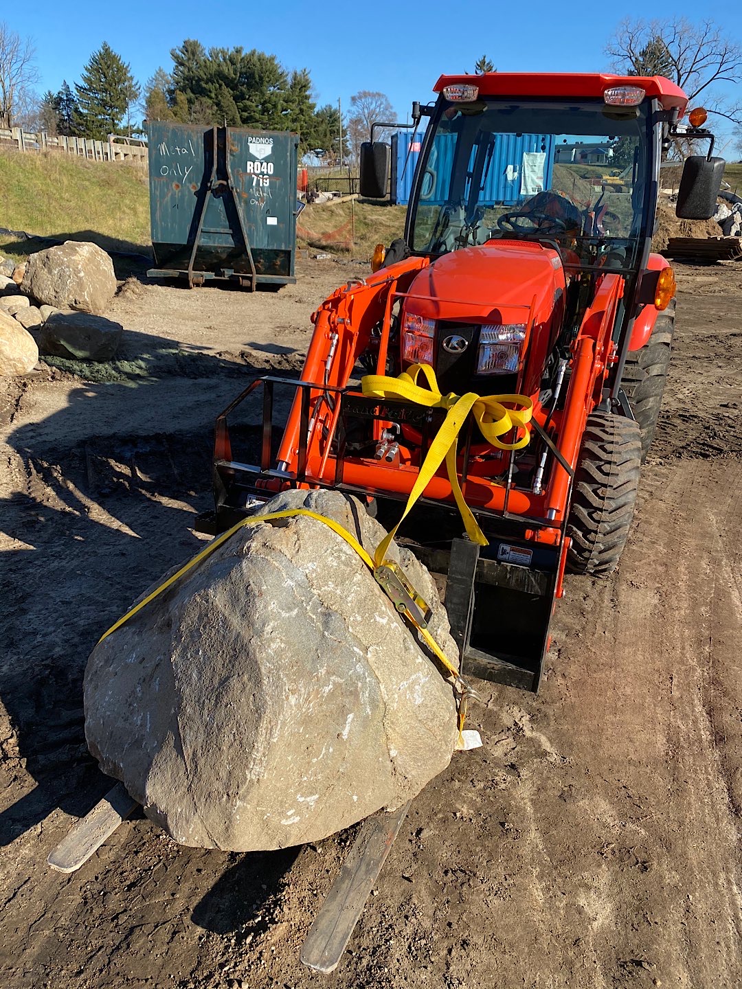

You should be ok with normally aspirated engine. Only downside I have with 4060 is the LA805 loader lift capacity. Oh, and the height as I need to dump into trucks with sides.
pokey1416
Jun 24, 2020
556
825
SW Michigan
I shouldn’t complain though it will lift a lot.

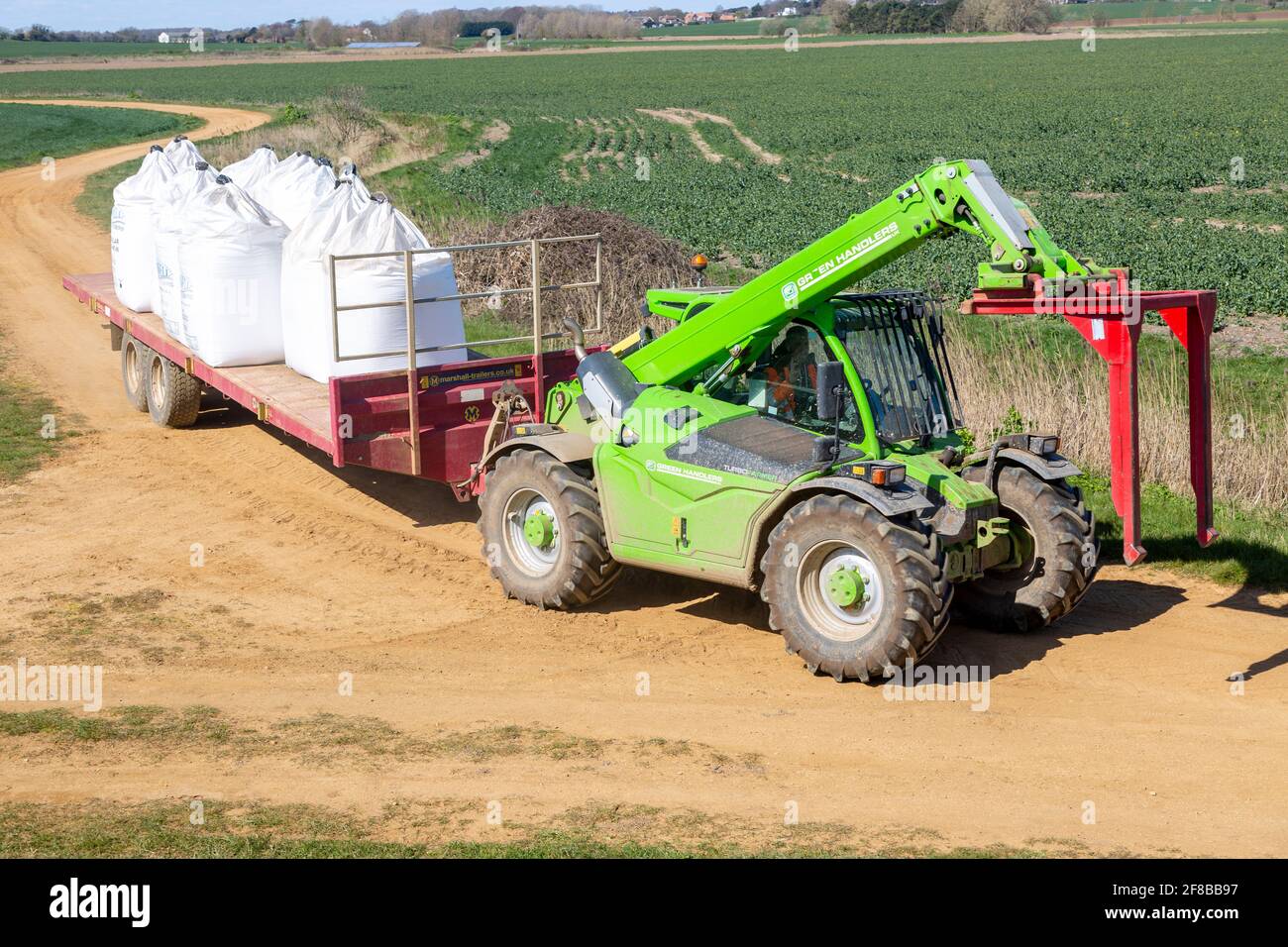

I would want big front tires for rough terrain, ride control/accumulator for the loader, front and rear remotes, and maximum tractor weight for lifting logs and pulling trailers/wagons.
If I didn't need a PTO or 3PH I'd consider a compact telehandler, wheel loader, or CTL over a CUT. Some telehandlers like Merlo have a 3PH and PTO. They will out lift, out maneuver and do more than any CUT.
