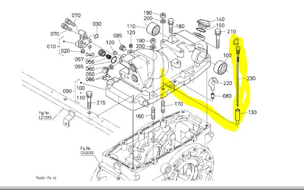

Reading various posts, a sight glass is mentioned near the left side of the PTO or by the clutch pedal. I don't see a sight glass or dipstick to check the hydraulic oil level. Am I looking in the right places for the sight glass to check the oil level?

On that model it on the left side of the seat, just under the seat.
