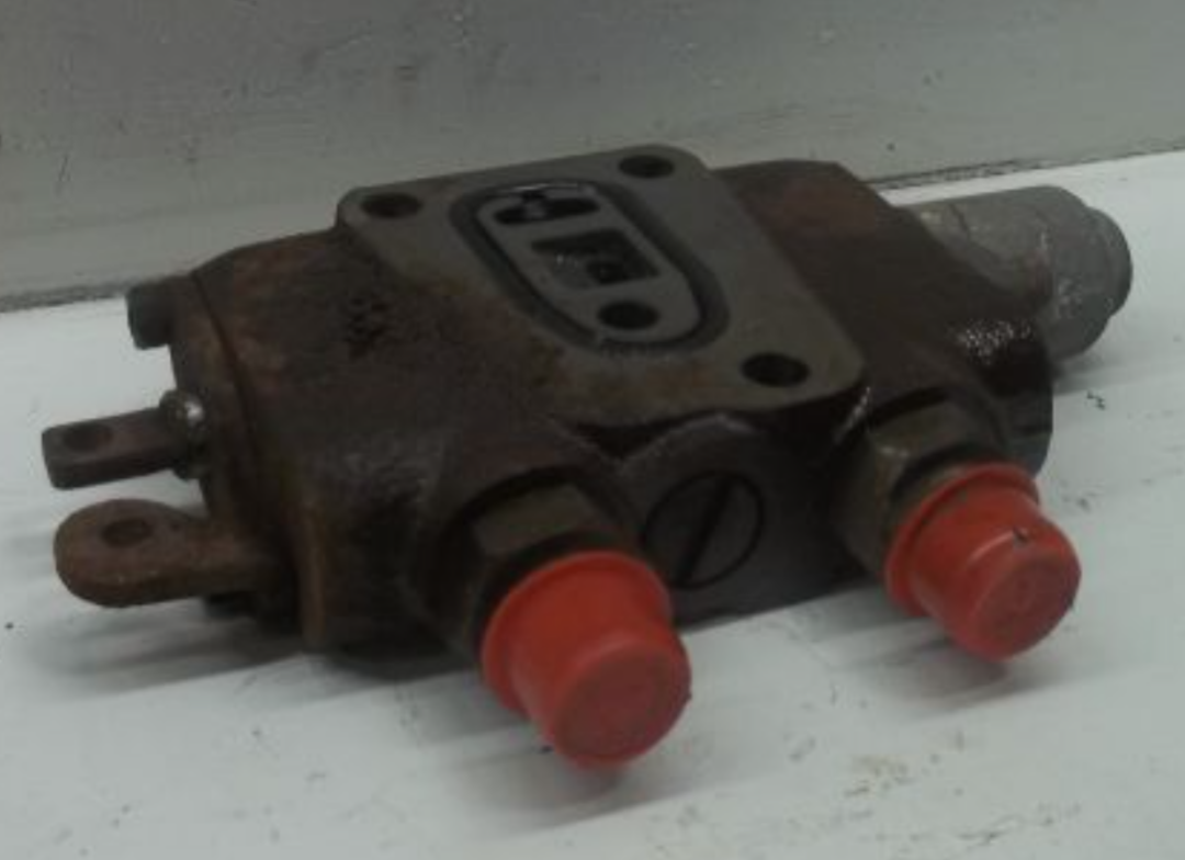

Looks like those are sections of a sectional valve. Here's a picture of a used one at Wenger's. I don't recognize the style, maybe @TheOldHokie does. Are you trying to avoid Kubota's outrageous price?

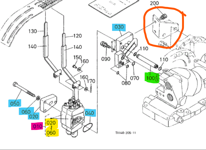

Your tractor has a hydraulic outlet block for connecting your loader. All you need is three short hoses. Additional off the shelf auxiliary valves can be daisy chained off the loader valve.
The aux valve you referenced to start this thread is part of the OEM aux valve package. It mounts under the operators seat using a custom hydraulic manifold and lever arrangement. It was an expensive option and most likely no longer unavailable.

The pn for the valve seems to include the manifold, endplate and tie bolts. He would have to purchase some O-rings, the levers/linkage, and the remotes with hoses to complete the install. Not the cheapest but probably the cleanest installation.
There is also a bracket that attaches the manifold to the rear axle housing and I don't know if that is available but could be fabricated. He may also need return pipe item 100.
"EDIT" That being said anything that shows 5-10 business days on Messick's site is subject to not being available.
8,520
4,329
That would not be the norm. Usual packaging is the base kit has the manifold and outlet cover. Then there is a coupler kit and a handle kit. Lastly you choose the valve.
Edit : Looking at Messicks site it does look like that's all one bundle and would have been ordered with one (T15001) , two (T15003) or three (T15005) valves. Couplers, levers, and mounting brackets were originally part of those packages but are now listed separately.

That parts diagram is pretty bizarre. T15001, T15003, and T15005 appear to be the whole goods numbers for one, two and three section kits and we are looking at the parts diagrams for the component parts spread out over a number of plates. There are separate plates for each valve count.
I have to think that if any of that is still available (big question mark) replacement sections could be purchased ala carte but based on other models its probably 4 figures.
I don't have a listing for the whole goods numbers but the way I read the parts diagram 010 is the valve ass'y and shows a quantity of 1. So that should mean one is required for the installation and should as shown by the 020-060 reference that all those parts are included in the valve ass'y.
They show no pn for a valve section alone and the closest thing would be the single remote pn.

Yes that's the way I am reading it as well. The numbers in the left navbar are typically the whole goods kit numbers. Just seems crazy that you could not buy a replacement section as a service part. The incremental cost on the second and third sections looks to be around $300 which is in line with current pricing. Outlets are real salty - $400 per set.
I'd like to know how they get all three connections on the same end of the stack.

On a side note I wish they would sell a section by itself as I wouldn't mind installing a third remote on my L4310.
The one in the picture in post #2 was just the section, used, at Wenger’s. I don’t know if they have the linkage, but you could ask or fab it yourself. I think the only action availabile is DA, spring center, but I’m not sure.
