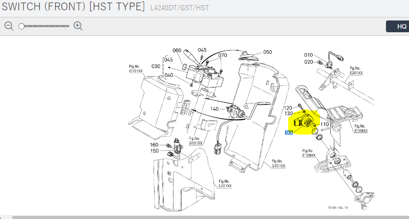

Sounds like your Auto Throttle Advance or the Stall Guard features not working correctly. Can't give any advise on checking it though.
6,533
2,148
When you removed the seat switch, what did you do with the wiring?
I believe the tractor needs to “know” someone is sitting on the seat before it will allow the tractor to move. The seat switch indicates that to the tractor somehow on some tractors.
33,584
8,826
Its sounding like you have a bad HST pedal sensor.
I need your Serial Number in order to figure out what generation of tractor yours is, as there was three generation of that model.
I can also help with the WSM (aka service manual) when I know which generation you have.

The L4240's in OZ have different serial numbers than in the US.
Your L4240 does not have a OPC (operator presence control) it had a ECU which does the job.
Your issue is most likely that the pedal control sensor is bad.
You'll need to talk with a local dealer to get the right part number.

Thanks Wolfman,
Since the problem doesn't happen all the time, is there a way to test the pedal sensor?
Also I thought that I had eliminated the seat switch from the system, but have come to realise that, that was the seat tilt switch, and that there is also a seat switch as well.
I have unplugged both and will try and run the tractor later today to see if that changes anything.
I do appreciate all of your help, thanks.
