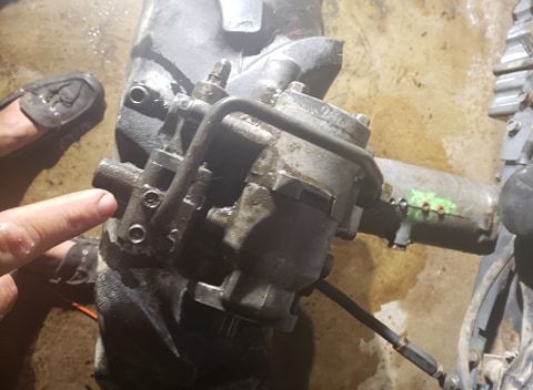

L4200DT strange noise coming out of pump line lift not working, as title stated, I bought it know it had a bad clutch, not the lift Is not working, make a noise an it coming out of this like a as I. Pic

Normally noise out of the pump and something not working means that the pump is cavitating and not moving fluid.
Suction leak, line issue, or possibly pump issue.

Should have asked me I would have given you a copy of the WSM. ;)
Just crack a pressure line, you'll have flow or you won't, pressure is not the issue.

Pull the hydraulic pump and check it for damage.

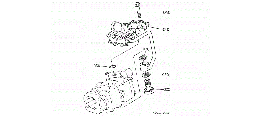

i was wondering what the front two valve do the front of the valve wolfman
Try again with the description of what information you're looking for please, maybe with less coffee or more sleep. :D

lol.... i know there are two valves on top of the pump... i mean two screws.i think its something to do with ps, btw order a used hydro pump from wangers, im fire it up after i put this red kote sealer in the tank
