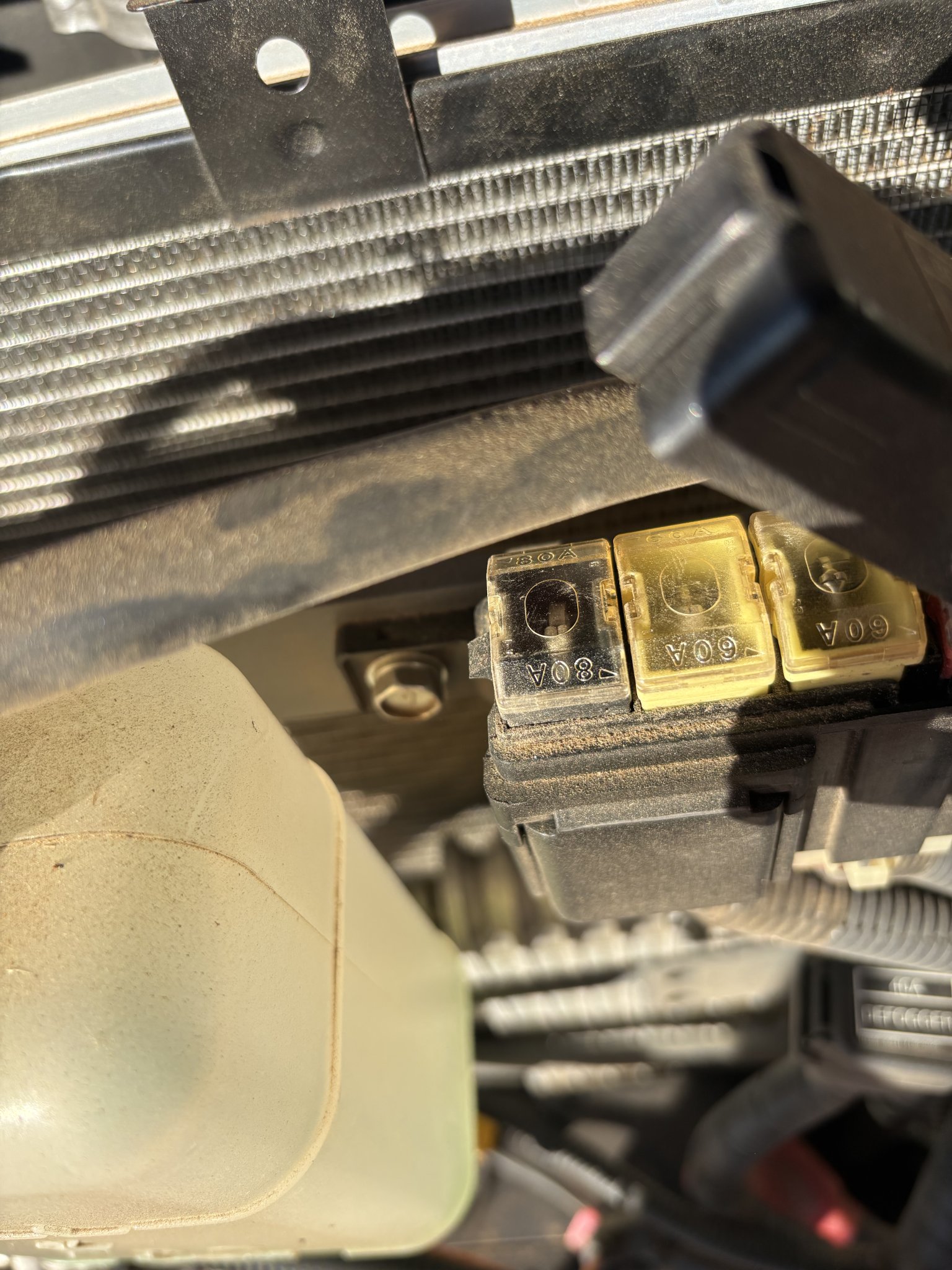

Morning all, well I have a question that even my dealer can't answer properly so I'm hoping someone can chime in and let me know what they have on their L60 tractor.
The main fusible link on my L4060HSTC is a 100a. The Kubota parts finder says it should be an 80a and so does my dealer. I bought it brand new around 8 months ago and that's what was in it. I sure as heck don't want to run a fuse rated 25% more if it was done in error on assembly.
So, I'm wondering if anyone minds confirming what they have in the fusible link box above their battery? First fuse on the left and I would appreciate the insight.
For reference, the Kubota part number is T1270-30580

Huh, look at that. Looks like a trip to the dealer is in order for an 80a. Better to be safe than sorry in this instance. I don't remember what the cover said on it as I'm at work now, but I'll be sure to look again as soon as I get home today.
35,151
10,367
It's very possible that it has an upgraded alternator if it has a heater kit, defrosters, and other accessories and that would also upgrade the main fuse. ;)
Downgrading the proper updated fuse could cause you some serious issues. :eek:
Thank you, yup you hit the nail on the head. I got a call back from the service manager who stated exactly as you said.

My 4060 HSTC as a 80 amp. It has a rear defroster.
GBJeffOH
L4060, EA Grapple, 6' LP Brush Hog, 8' snow plow, 6' LP tiller, EA Forks, Spraye
Nov 17, 2014
298
134
Jefferson, Ohio
Either you don't have the upgraded alternator or someone never changed the fuse.
If I turn on all the lights and rear defrost the volts drop to 12.4. So I think I must have to small alternator.
I have never used the rear defrost. I only use the cab lights.
