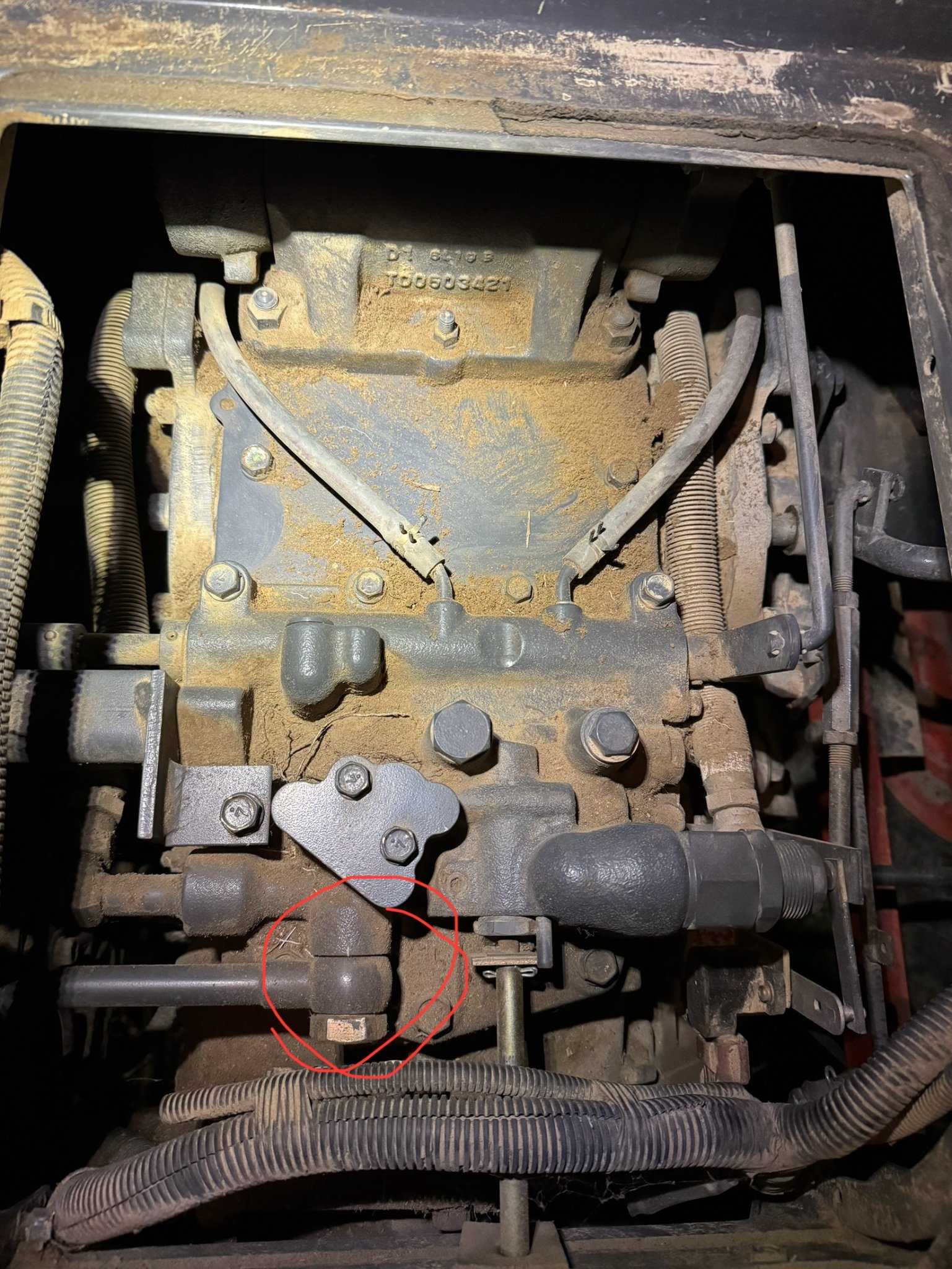

Bueltcm
L3940 HSTC with LA724 loader
Mar 16, 2024
Just because a picture would have been helpful as I started my install - here’s the banjo fitting for the Power Beyond tube beneath the seat. L3940 HST with a cab.
