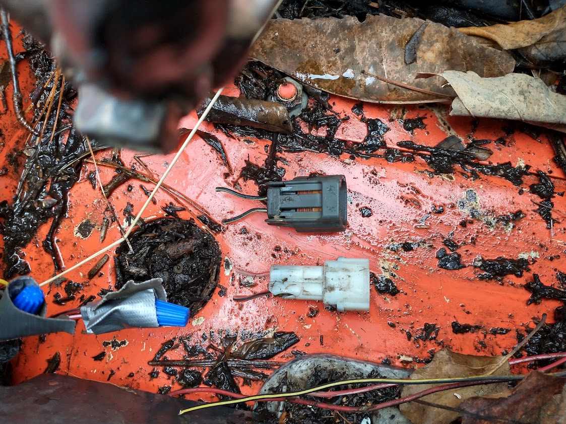

This is a 2010 model, quite some time ago I was having issues with the plunger seat safety switch and then the internal one (in the cushion). From what I recall, I put a jumper in both. Yesterday, about 5 miles from home and deep in the woods, it started exhibiting the same issue as when I jumped them, starts fine stalls under throttle. Being where I was with no tools and thinking I lost one of the jumpers, I cut off the seat side plastic connector with some wire to spare and twisted the ends to act as the jumper. It didnt work, same condition. (1st Picture)Thinking maybe the wire might have split under the insulation from piling tools around the seat, I pulled the harness out the back towards the 3 point hitch and cut off as much "spare wire" as I could before it joined the rest of the harness and spliced the wires together. Still no change. I called service at Kubota and they said to try disconnecting one of the splices as he wasnt sure if both switches needed to be "closed". Doesn't sound right to me but at this point I'll try again tomorrow. Tractor tries to move before it cuts out eliminating a trans problem.
Any ideas? I cant imaging there's a break in the harness between where I am and the motor as the wires seem to run high under the body under the seat. I have a friend with a telehandler who could come tow me out, but I'd like to get this squared away as there's work to do.
Thanks for any suggestions.

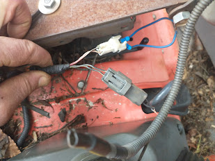

Thanks, that will be helpful if it is one of the other switches, but since I have cut out the 2 seat switches it will be no good in helping with a cracked wire etc. related to those two, which given the condition, I think where the trouble lies. If I cant get it going today though, I am going to order the new switches a splice them in just so I can start back from square one.
That said, I have not cracked my manual to look at the wiring diagram, but am I correct that the wires related to the seat switches run under the seat/feet and come up into the dash before going to the motor?
I ask because I did receive a big stuck stick in between the oil filter and the body. There is a big bundle of harnessed wire in that location (basically under left foot) which on preliminary inspection, did not look frayed or broken, though the oil pressure sender wire (single red) took a good shot (bent the steel cover protecting it).
*EDIT: I forgot, any credence to the Kubota tech suggestion that one of the switches is open and doesn't need to be jumped, or in this case have the wires twisted together?
